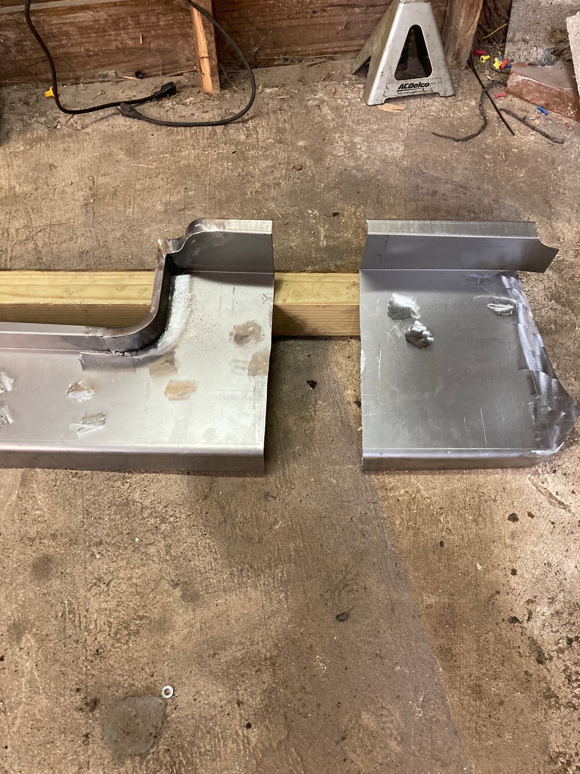

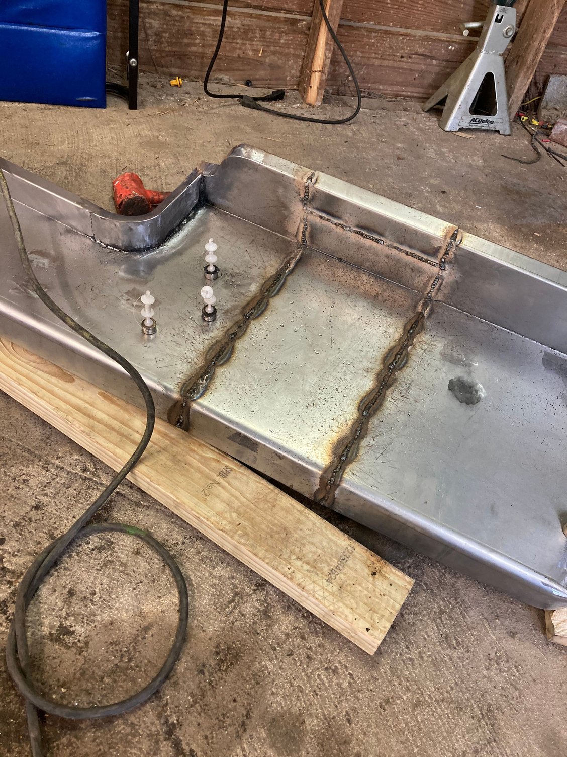

I went ahead and ordered the short bed running boards. They cost about $250, as opposed to $645 for the long bed. The difference will buy me a lot of welding wire! (And I’m going to need it).
Sure enough, they were exactly 8” short in the space right behind the cab and next to the bed. So I sliced them and fabbed up an 8” panel:

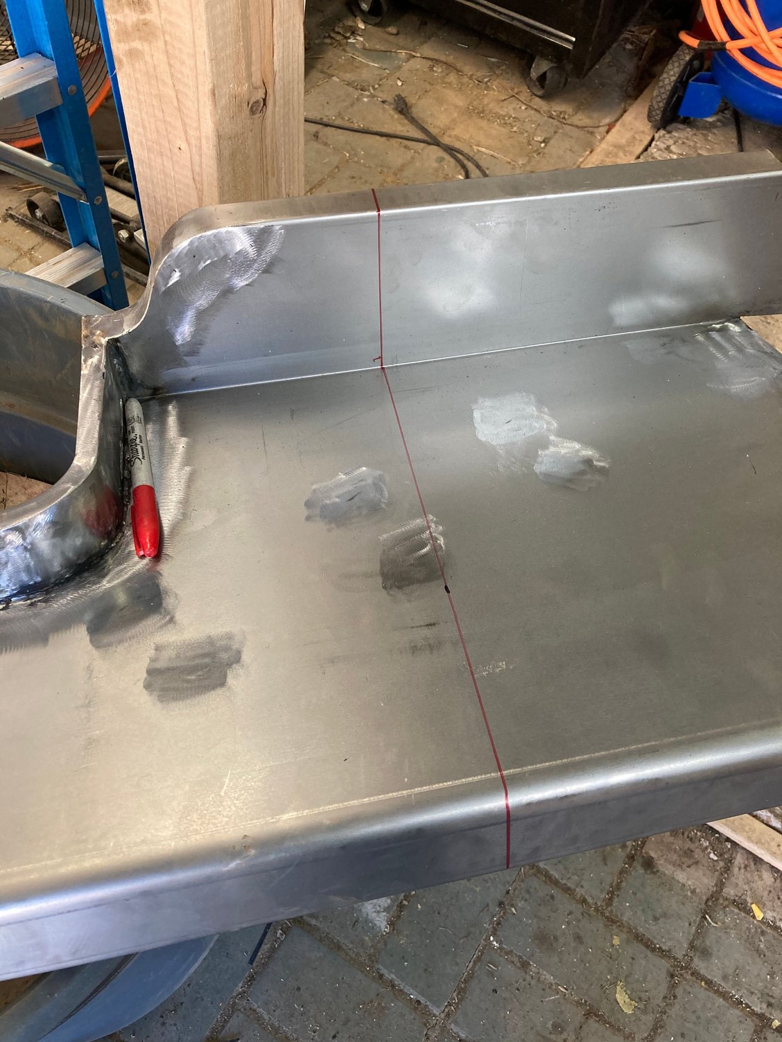

Piece of cake so far. But then came the test fit. I wasn’t thinking about the fact that the long bed is also wider. Turns out, the wide part of the running board by the bed is 10” wide on my original and 12.5” wide on the short bed version. My next step is to slice 2.5” out. I’m getting lots of practice on my body work! More pics to come.
