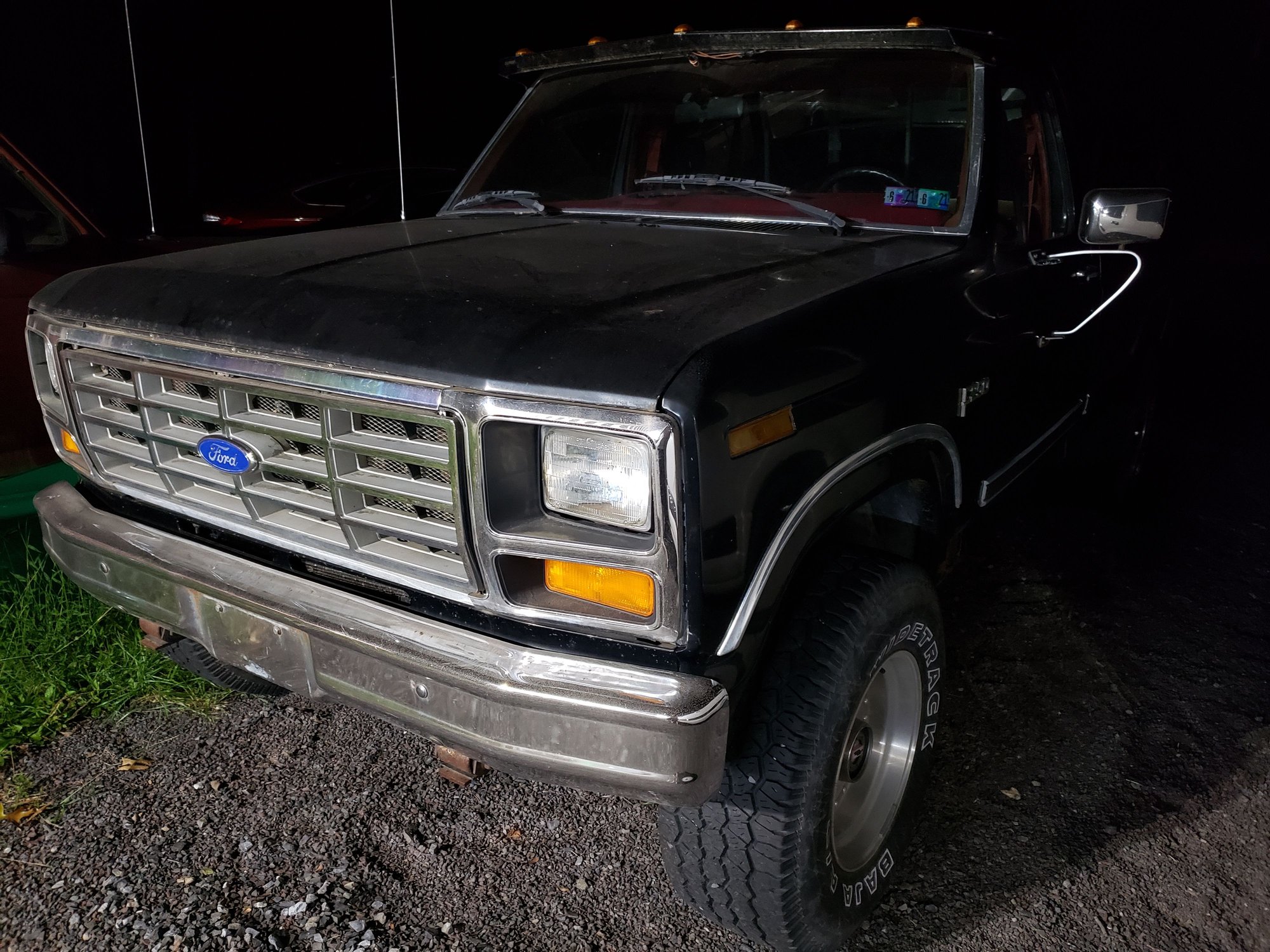

hi everyone, my truck is an 86 f250 with unknown mileage that has a junkyard engine in it that the guy said has "ohh about 100k". In other words unknown mileage as well. I put that engine in about 10 years ago. Its from an 85 econoline. Its a 351w HO carbed.
