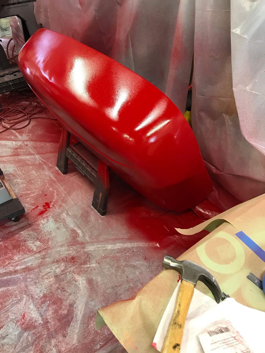

It only took 5 years but today I painted the cab and the bed. I still need to do the rear fenders and tailgate but progress is progress. It looks much better in pictures than it does in person. At least its one step closer to being back on the road.

Your spray booth looks just like mine did.
A year ago holiday weekend I painted my 81 F100 flare side. only took me 4 years on the cab off frame rebuild.
Looks great now get the rest painted and truck together so you can drive it.

I’m no expert, far from it, but it looks to me like all you need to do now is wet sand the orange peel and buff it out. The color coverage looks good and everything looks straight.

I'd mess with your gun some more and see what is causing the orange peel. I painted a fiberglass pickup canopy black once that orange peeled real bad because I was using the wrong temp range of thinner/reducer. I took a scotch bright pad (the kind sold at the paint store) and went over the whole thing to smooth it back down, cleaned it and re-shot it again with the correct stuff and it came out looking like glass.
OR you could wet sand / buff. So long as the paint is thick enough that should give you nice results, just add extra elbow grease and stay away from the edges.

Finished today with the rear fenders and the tailgate along with a few other small things.Ran out of paint so a lot of I'm leaving it as it is. A lot of wet sanding etc in my future. Now I just have to remember how to put the bed back on the frame and since its painted I'm going to have to bribe someone to help me. Thanks everyone for the positive comments.
