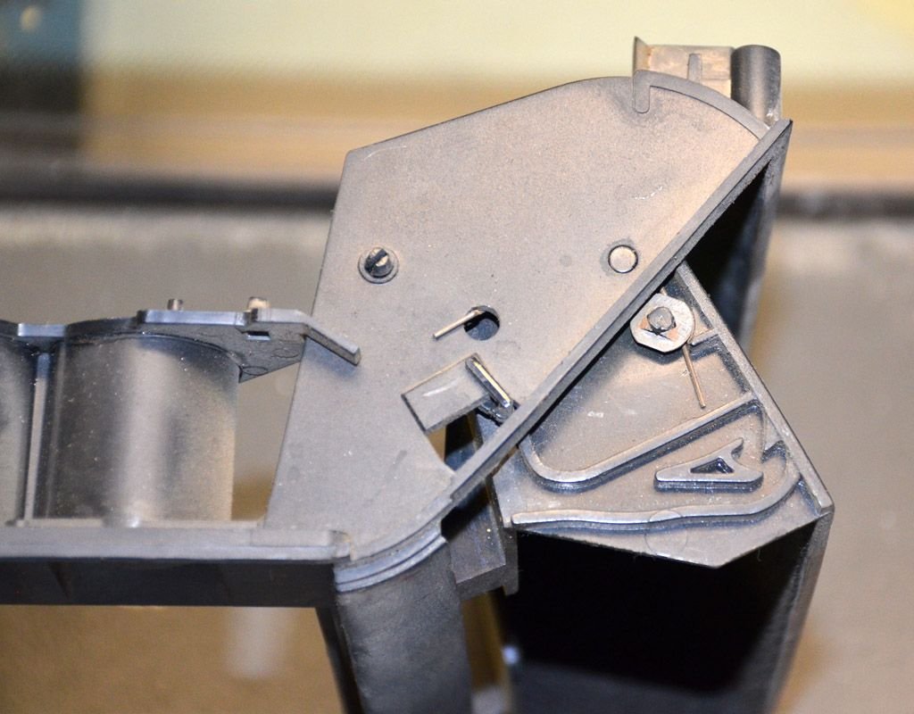

The spring is wrapped around the left pivot of the door and anchored on one side by the case and on the other side through a hole in the frame. If it popped out, that means the plastic stud that forms the pivot of the case either popped out of the frame, or broke off of the case, or both. The studs fit into the frame by somehow expanding and distorting the frame. Be careful that you don't crack either.

Thanks again! All fixed!! Took about 1 minute once I knew how to put it in!

Excellent.
Was the spring actually popped out, or was it just the ends popped out of their anchors?
