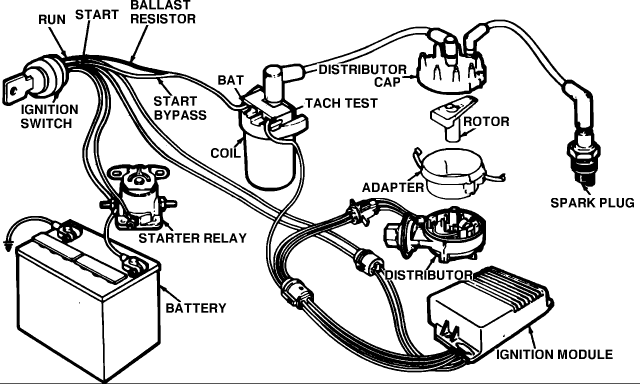

I don't know about the decoupling question. Not sure what happens to the carb when you take the distributor out of the equation. Not familiar with the Feedback System.
That said, the Duraspark 2 is a pretty typical route to take. You will need an ignition module, for one thing. AutoZone sells them for $30 with a lifetime warranty, part number F102. I use Summit for a lot of things, and they have the Motorcraft brand for $62.99. If you're a name-brand guy, that's an option. I gave my spare junkyard one away ages ago to a classmate trying to get a Bronco running that promised to give it back when he got a new one. It never happened.
You will also need a distributor. There again, you have options. Have the parts store of your choosing look up the distributor for a 1983 F-100 with the 300. I bought this Duralast Gold one with lifetime warranty for $76 for my new engine. My old one worked fine, I just wanted the new and shiny.
You may or may not need a coil. I don't know what coil those came with. The 1985 engine I put in my truck had a TFI style coil on a bracket in front of the fuel pump, so I assume yours might be the same? I think that one was feedback carb. There's a difference in resistance, I believe, the old one may work, but the preference would be to swap it out. I put this coil from Summit on my new engine because I liked the color lol, but any of them would work.
Painless Performance makes a wiring harness to cleanly connect everything, but if you're a junkyard or DIY guy, there's options. The junkyard for one thing lol.
If you're a DIY guy, the
Standard Motor Products S583 Standard Motor Products S583
is the plug for the coil.
You would need
an SMP HP3935 an SMP HP3935
to go to the distributor.
An SMP HP4735 4 pin connector.
(RockAuto carries several brands to find the ones in stock...)
I know there's one more plug that goes to the factory harness, but you may just want to wire that one directly. EDIT: Never mind, if you want to keep the warranty on the module, might just want to get the plug...I don't have a part number for it, but it appears maybe an SMP S629 may work? With the third prong not being used? I am not sure on that one....
For the time it would take to build, I would personally buy the more, erm, painless option, but that has more to do with laziness than fiscal responsibility.
There's more in-depth wiring diagrams out there, but that should give you the general idea.

Adding to what he said, rockauto.com has the motorcraft icms for $50 and clipsandfasteners.com have the plugs to make your own harness in the $5 range last I checked.
If you're a DIY guy, the Standard Motor Products S583 is the plug for the coil.
You would need an SMP HP3935 to go to the distributor.
Great, thanks. I'll probably come back with questions on the conversion. But I think I have a vacuum leak here, and I need to get that fixed first.

Vacuum leak, maybe, maybe not. You would think if you were pulling in a lot of air, the engine would run fast, but run rough because of being lean. You would think spraying a fuel into the carb or holding the choke a little bit closed would make it richer and run even faster. It's hard to say. While all engines seem to be a little different, my feedback system would run fine during start up, but after it warmed up it would suddenly idle very fast and had a miss-fire. I traced it down to the timing was suddenly being advanced for whatever reason. Guess what controls the timing on the feedback system? The computer. I pulled the codes and had so many error codes, would have took hundreds of dollars, countless hours and hunting for obscure parts that I possibly would not have been able to find.
I then decided to convert. Like I said, all engines are different. In my case all I did was change the distributor and ignition module. I am still running the original computer controlled carb, the wires are just not hooked up. It runs so much better than it did before.
If you get a duraspark II distributor and ignition module and get the harness inbetween the dist and the module, the rest will plug right in to your original factory harness you have now, it's already wired for it. They had many different engine setups that used the same harness, some had the duraspark II system with this harness from the factory, your truck has it too.
Or you can buy a aftermarket HEI distributor and stab it in place and wire it in.
If you think you are having carb problems, you can get them new also online.(the regular type with no wires).
