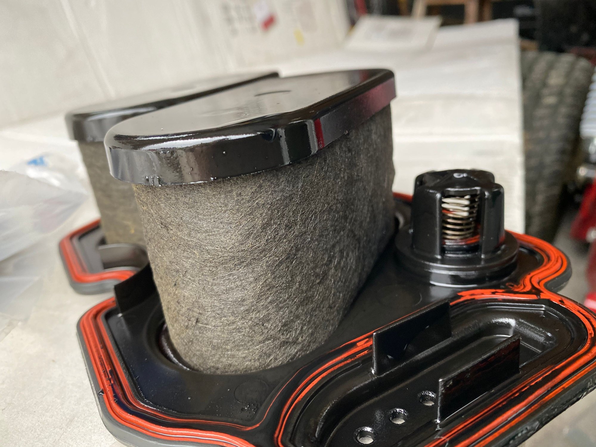

Ok guys I found the issue and solution, this is exactly what mine is doing! Although not to the point of spitting oil out just yet. My truck has 87,000 miles 2,105 engine hrs and 303 idle hours.Enjoy!

Not a difficult job took about 20 minutes, just awkward, I used a regular 1/4 inch ratchet and 8mm socket. Definitely needed doing, no more pressurized fill cap, if let go too long it would probably blow the oil pan gasket and rear main seal amongst other things. This is going on my maintenance schedule, maybe I will include it with every fuel filter replacement, or every other one. I’ll see how it goes, a good way to tell is take off the fill cap when running, I’ll check it every time I do an oil change. Most painful part is the price, I paid $230.00 from the dealer up here in Ontario. It’s probably cheaper online but I needed to have it now as I’ve got a couple of long hauls next Monday and Tuesday. Part number is FL2077

I don't see it listed, what mileage on your truck before the CCV filter became clogged to this extent?
