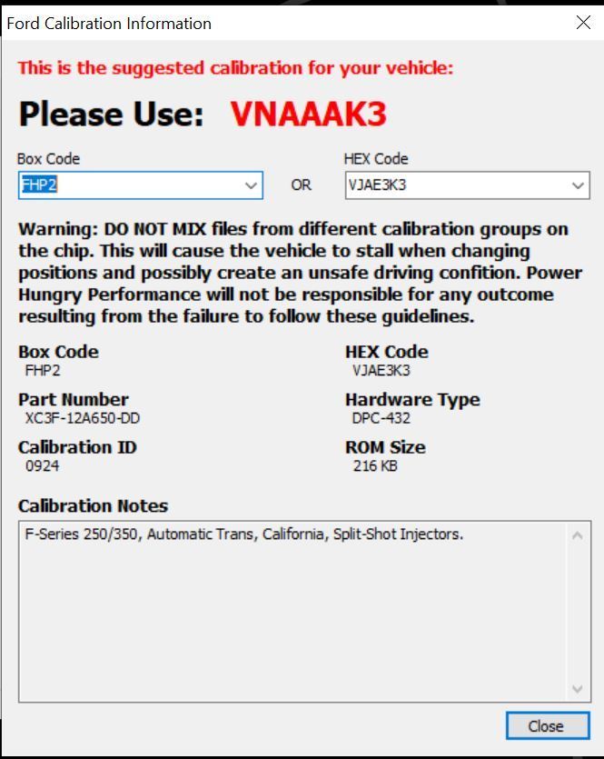

I have 99.5 auto trans with single shot 160 injectors along with a KC300x 63/68 .91 turbo. The hex code of my PCM is VJAE3K3. I would like to install tunes from the expanded Hydra library (purchased). When I look at the hex code there appear to only be tunes for standard calibrations (split shot injectors). Is there a different hex code that I can use? Are there drawbacks of using a different hex code? In the hex code tool in Hydra it says to use VNAAAK3. Unfortunately for the hex code there are only standard calibrations as well.

The expanded tunes will note show up until you hook the chip up and scroll through the tunes, they
will list the by injector cc and nozzle size

Correct, I have done that. I see 160 for numerous HEX codes, just not the two I listed above when using the calibration search filter.

I would call the vendor and ask , either php will add your code or recommend a different hex

I have contacted the vendor and am awaiting a reply. I was hoping someone here, maybe @cleatus12r , would have a suggestion about compatible HEX codes.

No idea about the HEX compatibility.
I have purchased Hydra Titan unlock from CNCfab.
But i was also little confused when there was only stock injector calibrations for my WMAA8M9...
CNCfab contacted to PHP and they added the calibrations in few days.
