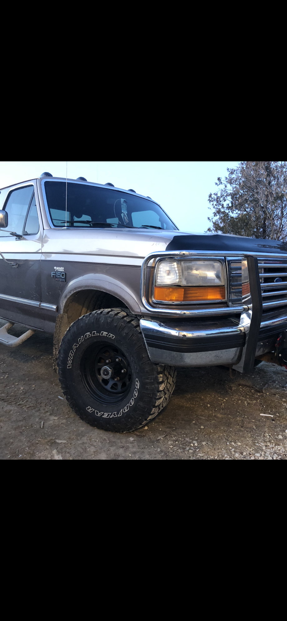

This is with the ice fishing wheels on.

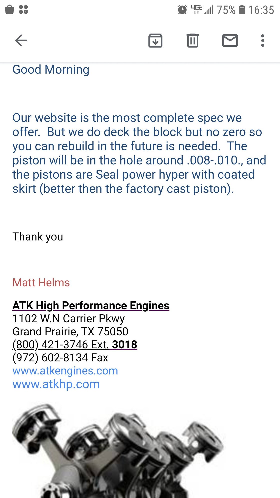

This is a reply mail I received when I asked about deck height on their 351w part number SP09.
Now this engine is without heads or cam, but you said you recently redid them, so reuse yours. Google atk engines and looks up short blocks. I think they are like 1300 and a 200 core.
The basic info
  • Block: Seasoned OE 351W Non-Roller 1988-1993
  • Bore/Stroke: 4.040 x 3.500
  • Displacement: 351 C.I.D.
  • Crankshaft: OE Ford Cast 3.500" Stroke 1 Piece Seal Externally Balanced 28oz
  • Connecting Rods: OE Steel 5.955" Stock Bolts
  • Pistons: Hypereutectic D cup dished
  • Piston Rings: Moly Rings
  • Compression Ratio: 58cc=9.4:1/64cc=8.7:1/70cc=8.7:1
  • Camshaft Bearings: Installed & Clocked to OEM Position
  • Freeze Plugs: Brass Installed & Sealed
  • Oil Galley Plugs: Installed & Sealed
  • Weight:285
