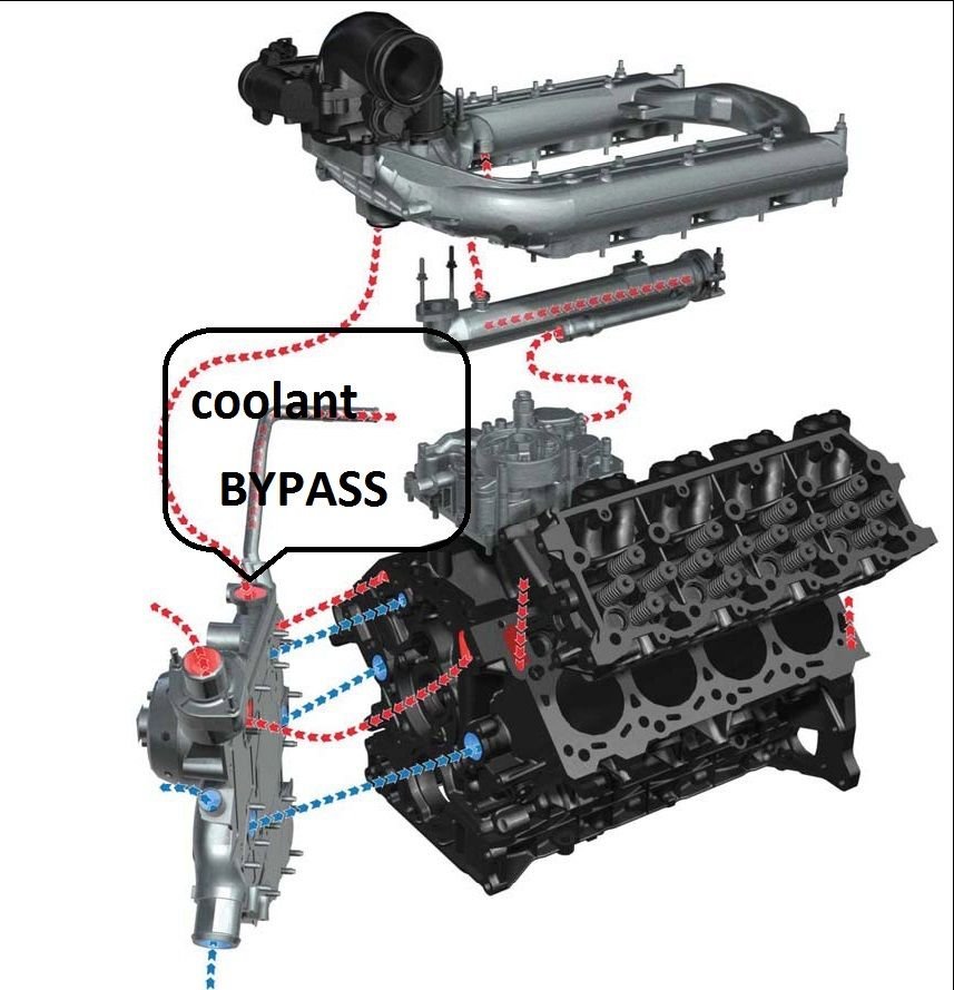

Came across this. Looks to be like a bypass hose would do on a 5.0 gasser
Originally Posted by Visurveyor
If it has the vacuum cut of valve for AC. water will not flow to heater core when you have Max AC on.
EDIT: "will not flow"
If after the valve if Im not mistaken?

Look at the Sinister video. It is BEFORE the vacuum valve. BEFORE means the side towards the front of the engine.

For those that have a vacuum valve, the flow to the heater core will shut off when the AC is switched to MAX. It's common to splice in the bypass filter before that valve if you have it. Depending on where your filter output goes will determine if the flow continues when the valve is shut off, which is why most people put the filter return into one of the degassing lines heading back to the degas bottle. If it's a 3/4" flow, then it goes into the heater out, return line, which then will diminish the flow through the heater core.
The heater circuit is a bypass in itself. A bypass from the normal engine flows to provide heat. It will operate no matter the thermostat position. So the bypass filters are a bypass to the bypass in technical terms, but in reality flow as best they can no matter.
