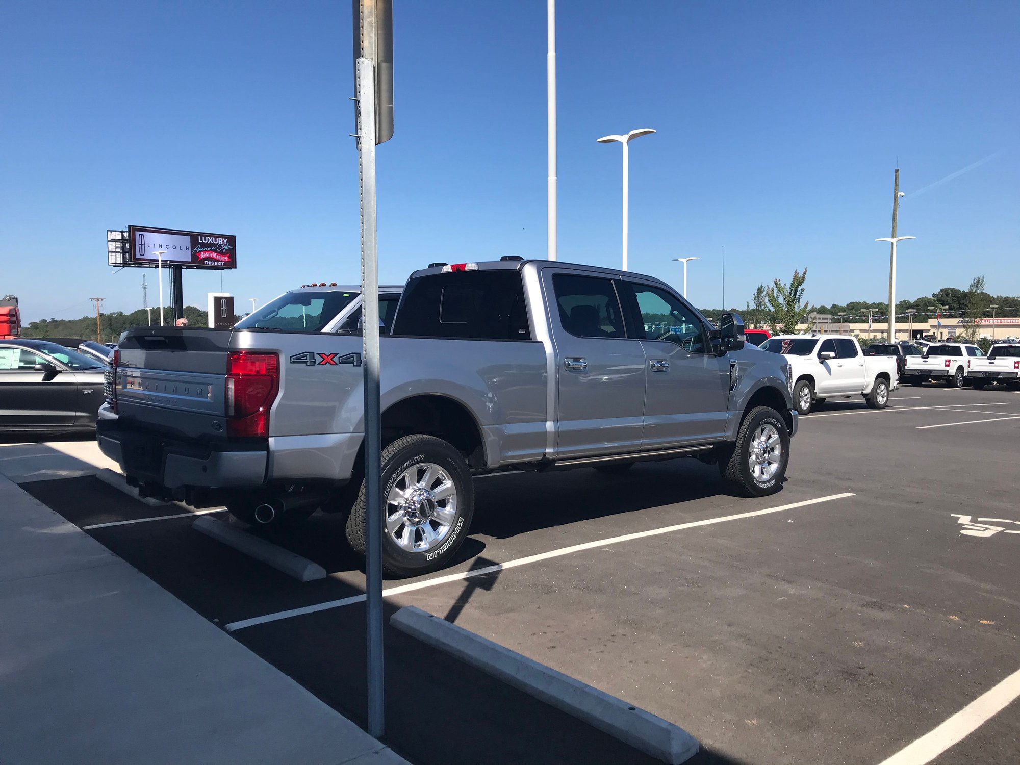

Where is the rest of the Pic of the truck ???!!! lol Gee hope they don't do that with my Silver Spruce

Best that I have at this time. Platinum trim, no sunroof. Looking for some wheels and tires but don't like the negative offsets. Best I have found are +20mm with a 9" wide wheel. That will bring the wheel outside about 1.5". Looking at the 295/65/20 Michelin LTX tires. Hopefully I
can keep the overall tire no more than 2" from stock position. Don't need off-road tires, just looking to personalize the truck.

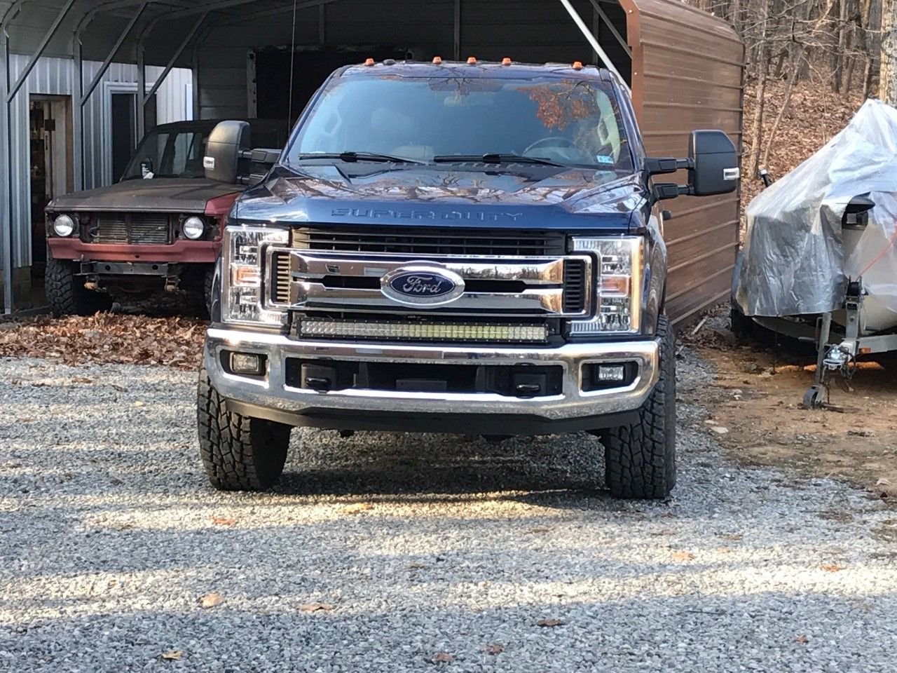

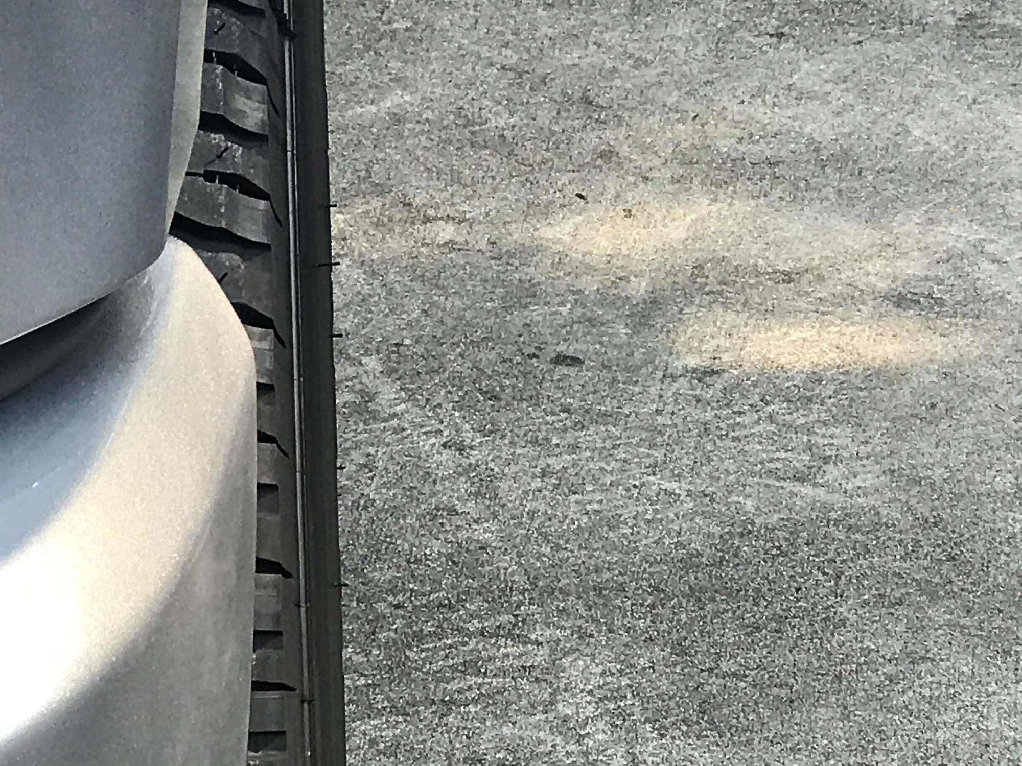

+20mm shouldn't stick out that much. I have 0 offset, 9" wide wheels, 285's, and they don't stick out that far.

I have +18 on 9's. They stick out just enough to look cool while pretty much maintaining the factory engineering.

Factory wheels are +44mm. 25mm equal 1”. Plus the original wheels are 8 or 8.5” wide. You do the math. A +20mm wheel moves the wheel out 1” all by itself from stock. If the wheel is wider you get about 1/2 of that width on the outside also. I might could live with the difference with an aggressive tread design, but with a street tread like the LTX, not sure. Might just have to give it a go and see.

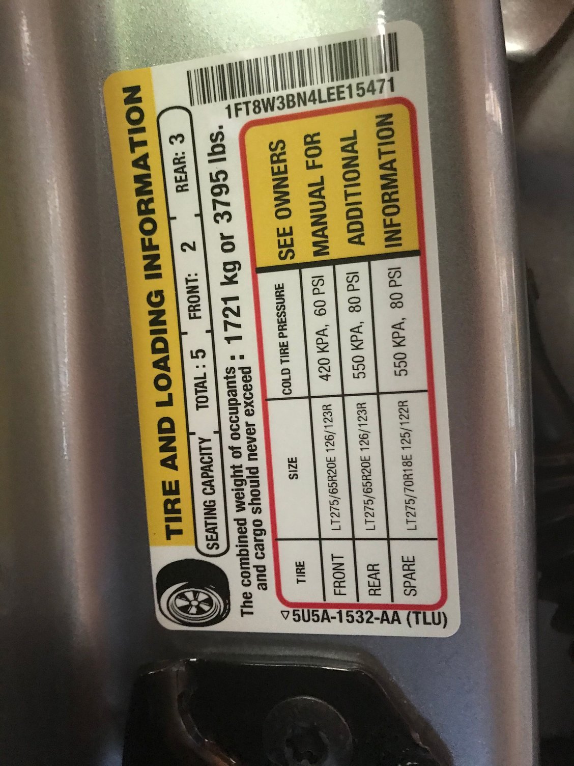

Just for info here is the weigh sticker. CCSB. 7.3. 11,300 GVWR

How does Ford come up with that number? My sticker (CCSB 7.3 F250) say no more 3118 lbs. But, the sticker has my 18" stock Goodyear AT tires at 65 PSI only, even though the tires are marked for 80PSI. If you add up the tires, they can handle a combined weight of 14k+. Plus, 3118 total cargo and passengers seems a little low for a camper package. I guess it's that 10k package sticker, because the numbers don't add up.

Sorry for the thread drift but I’m curious what light bar that is.

Its the gvwr minus the weight of the vehicle with a full tank of fuel.
Your F250 has one less leaf spring and lower tire psi.

Been going strong for a year and a half, and I use it every day (I work nights). Like with all cheaper light bars, a little extra silicone goes a long ways. I popped the end caps off and put a bead of silicone in there to seal up any potential gaps or pinholes. I don't know if it was needed or not, but it helps me sleep better
