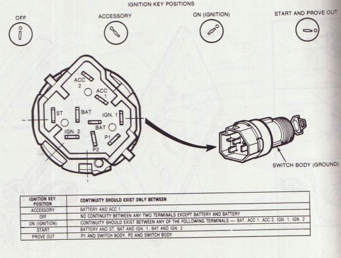

There is also the difference in ignition switches. I used an ignition from a 79 in my truck, because it had more leads on it.

Yes I think the older was a 6 pin and I know a 78/79 is a 9 pin.
