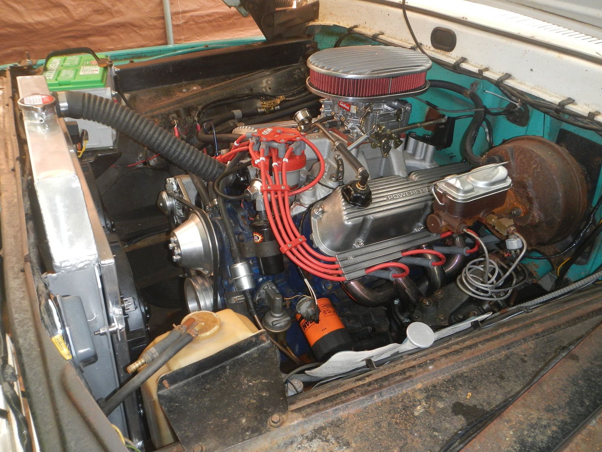

I did it on a 66 w/435 no problem mechanical. But stock
exhaust manifolds were not truck friendly, driver side to close to firewall and required shorty/block hugger headers.

sanderson block huggers for a 351w in a 65 fairlane. worked perfectly, little pricey.
