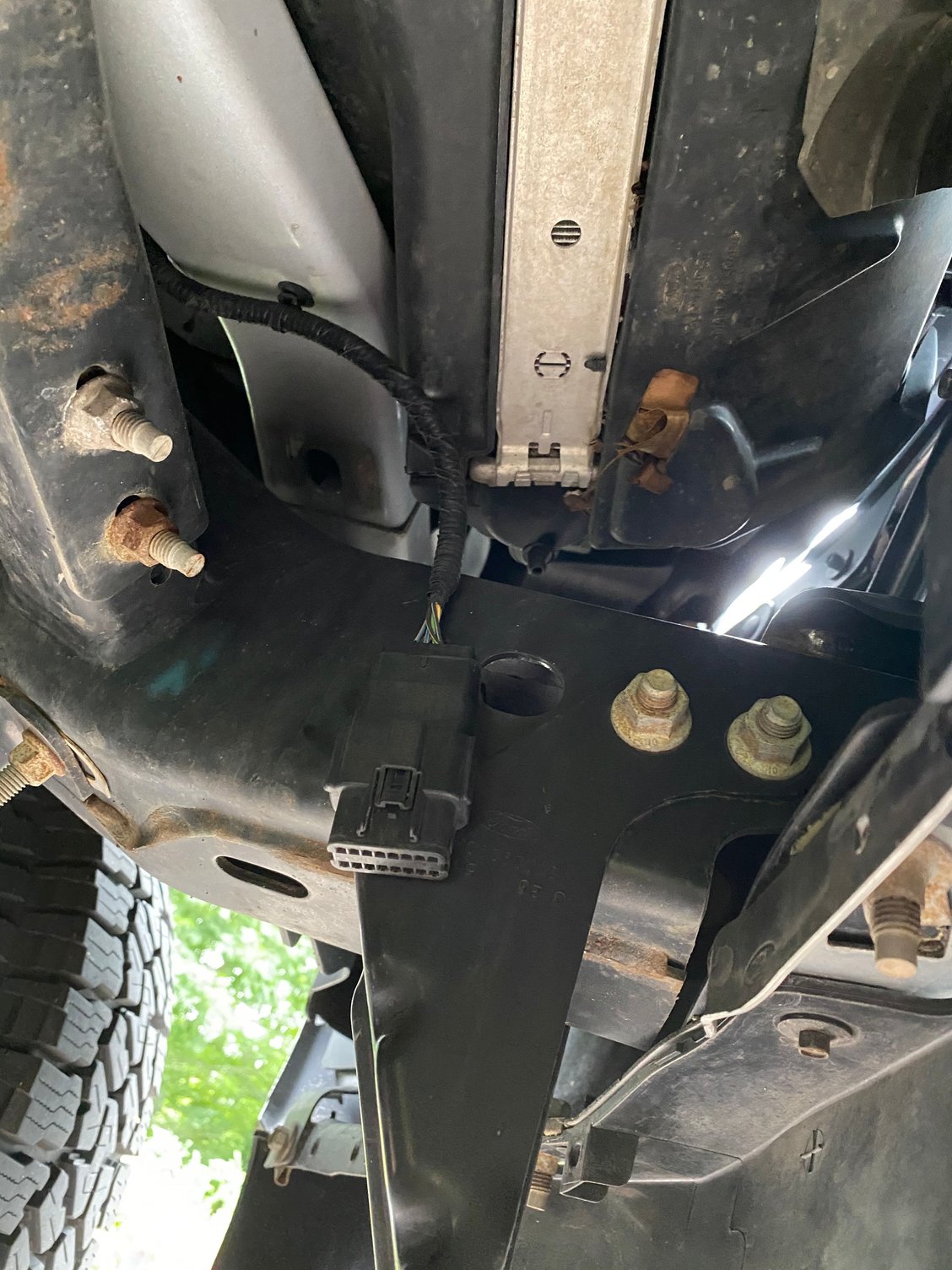

Plug under bumper
Anyone know what this plug is? Plow hook-up? Mounted to the frame behind the front bumper.
Do you have fog lights? Looks like on my truck that plugs into the wire harness that runs along the top of the valance and goes to the fog lights.

Getting ready to install my RA bumper and pulled mine off a '19 F350 XL and was wondering the same thing.

That is the fog light harness connection.

Originally Posted by GNR22
So the XL trucks and trucks not equipped with fogs are equipped with the plug for them? That's handy.
That harness is on any truck with power equipment group.

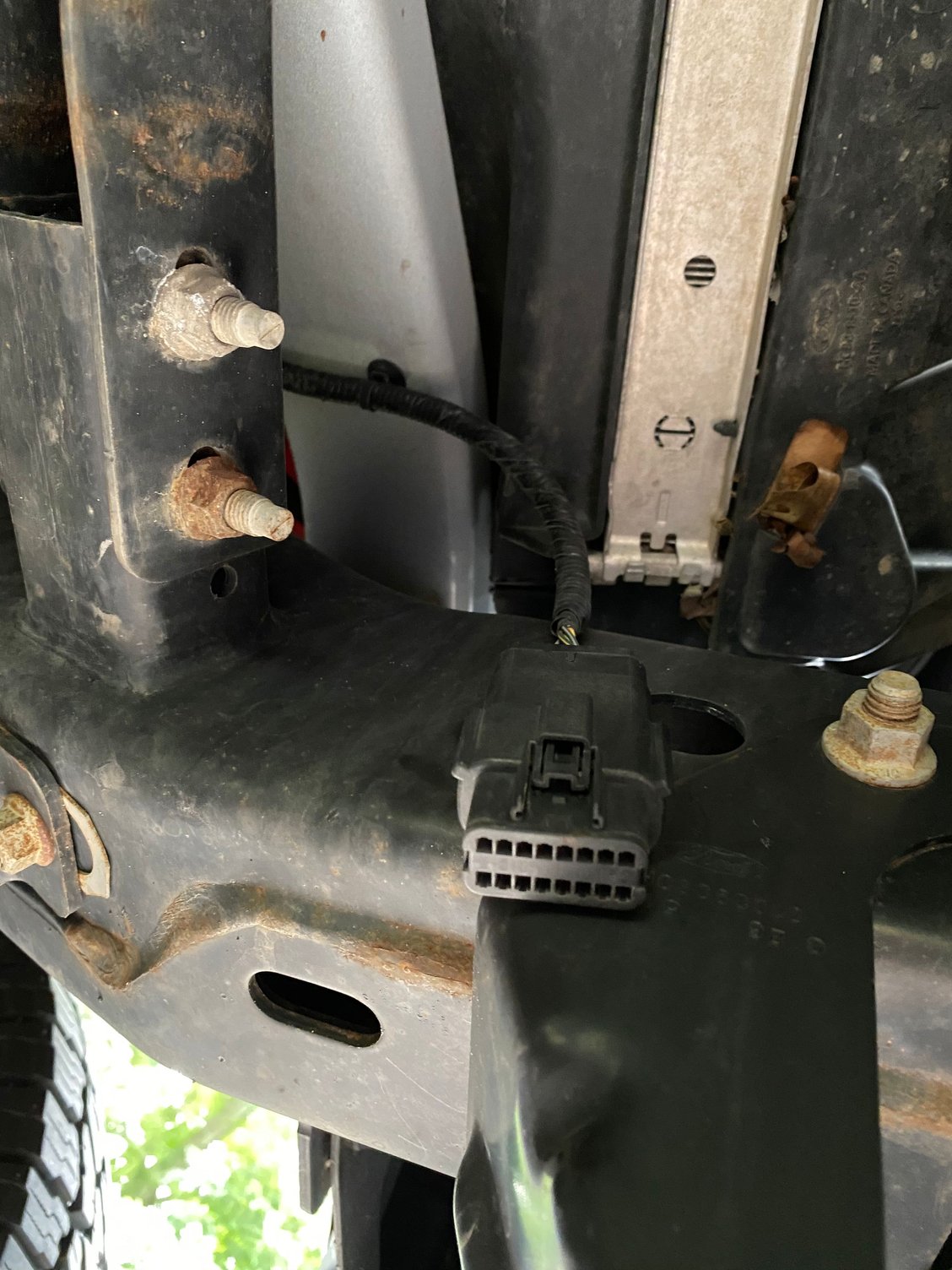

Wiring diagram for plug on chassis?
I’m trying to figure out what all 8 wires are on my 2021 super duty, I know 4 on the harness from my bumper are for the lights but what are the other 4? Trying to see if I can utilize any of them for some marker lights I installed on my valance I want on when my running lights are on
I used one of these t adapters. Works great..

Four of the additional wires on my 2021 were for adaptive cruise radar sensor. 2 CAN wires and the other 2 for power and ground.
