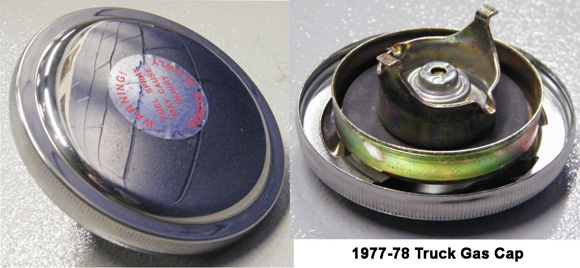

This is the different caps they are talking about.
https://www.macsautoparts.com/ford_t...thru-f250.html
https://www.macsautoparts.com/ford_t...1973-1976.html
https://www.ebay.com/itm/OEM-Ford-19...-/123869262813
https://shop.broncograveyard.com/197...uctinfo/20361/
https://shop.broncograveyard.com/197...uctinfo/20365/
Keep in mind if you order one, that their can be a difference in them. It has to do with the length of the neck or the part that is going in the fill tube and where the lock tabs are, depth wise.

Yes, the white one you have pictures is correct for the front tank and the black one for the rear. paint to match, nothing else looks right.

Thanks for the back up. I was just showing him the different caps and the neck height difference. That is all.
