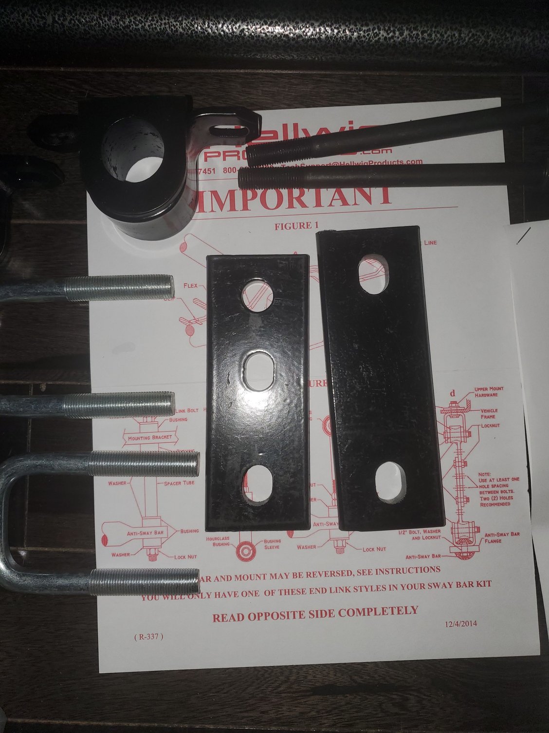

Question for those of you that have one installed (2wd). Shouldn't these two plates be identical? The instructions only show the passenger side, but I'd think the driver's side would have the same plate, otherwise what does the u-bolt attach to?

Not right., I think the longer one would go to the aft "I" beam, and it's missing a hole. The extra hole is for the end link.

Okay, thanks for confirming I'm no crazier than yesterday. I swear I've never received an order from Summit that didn't have one hiccup.

Here is how mine looks, but I had to get some longer U-bolts from Hellwig.
