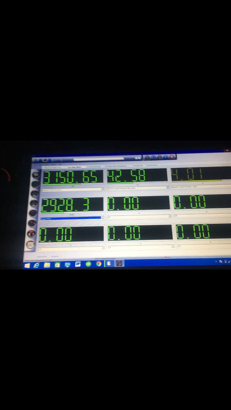

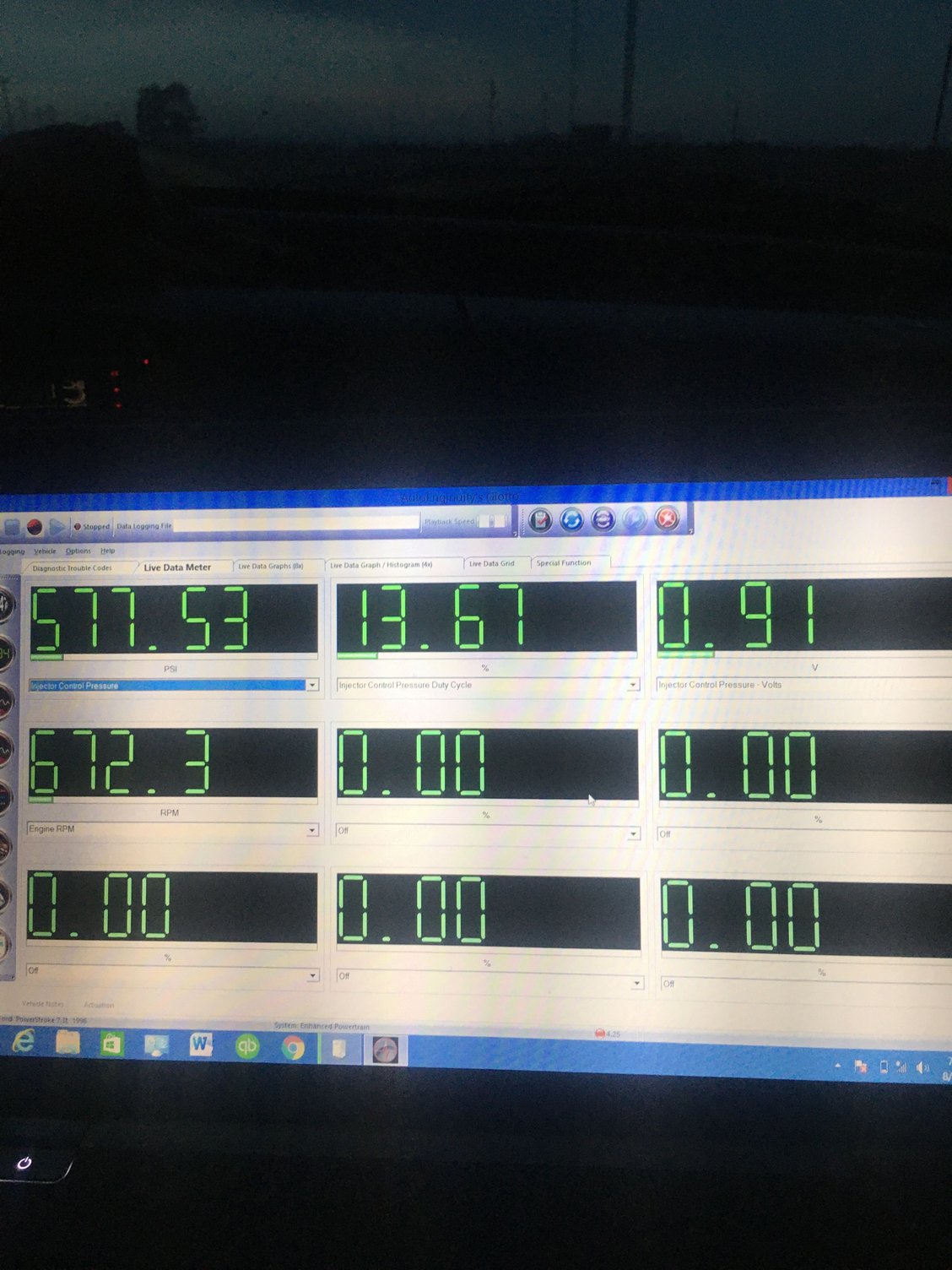

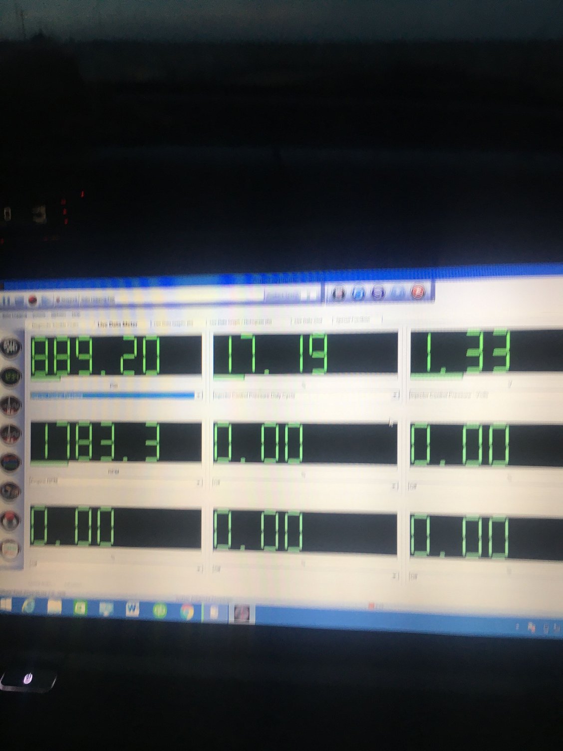

Got some data today. First number is hpop pressure (ICP) next is ICP duty cycle 3rd is ICP volts and the lower one is rpm
first picture is cruise control set at about 50 mph in 5th
Second is WOT
And third is warm idle

14% at idle shows me your pump is tired. The new Adrenaline I installed dropped me to 9% at idle.
When you hit 3100psi, is that with a tune? What are numbers at 3200rpm full load in 4th?

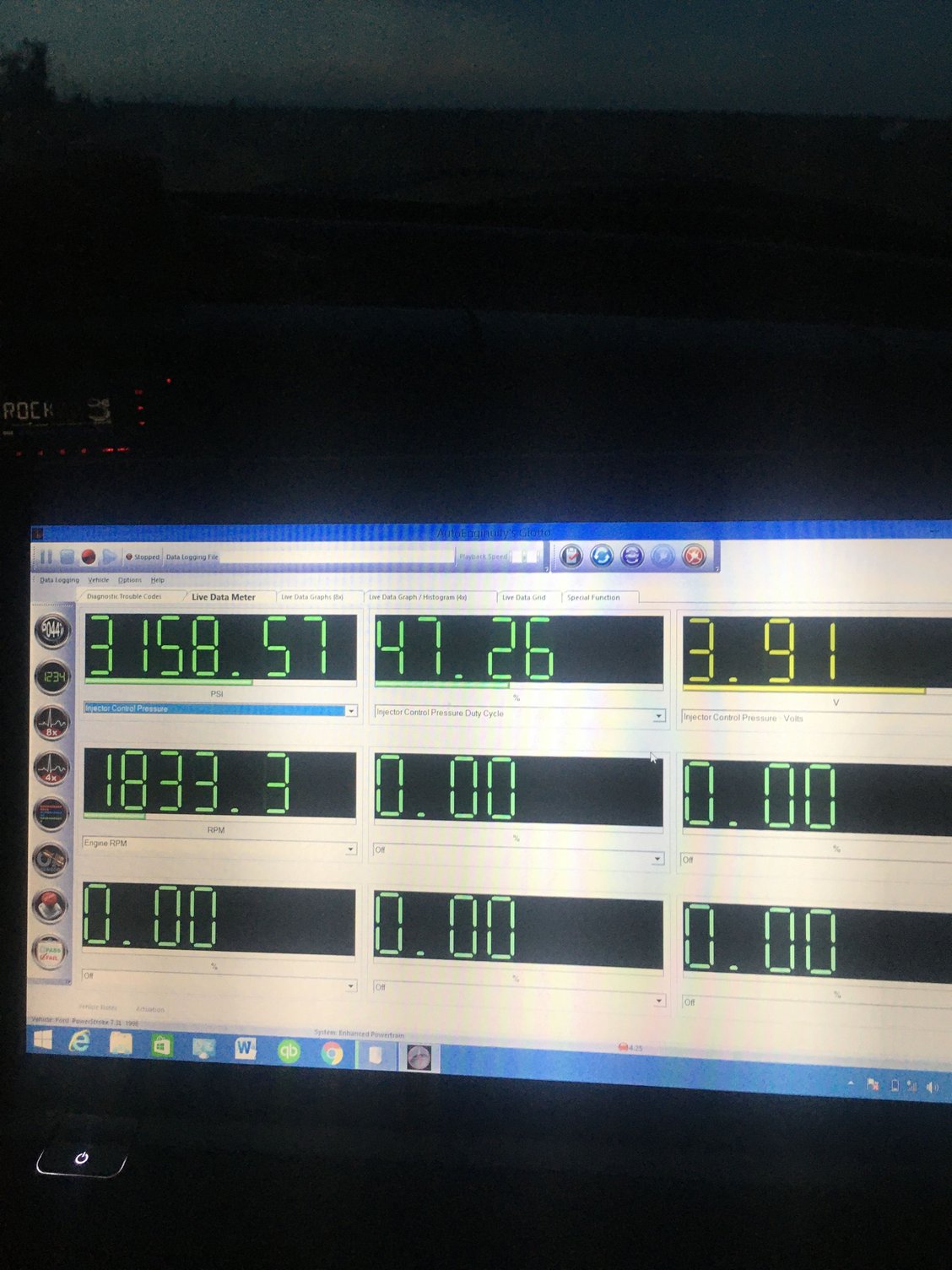

So did some more testing today. 3100psi is in my daily driver low tune. I didn’t get a chance to see what it was in a hotter tune. I unplugged my ipr today and ICP to check for oil in the connectors and there was nothing. So I hooked up and drove for about 45 minutes and I just got back. The whole time it didn’t act up at all!!! Could my problem be caused by a dirty connection on my ipr or ICP? I’m going to clean those next. I’ll attach a picture of wot I think in 3rd at about 3000rpm that I got last night. I’m hoping that’ll tell you what you’re wondering

Is that a commanded number or actual on the display?

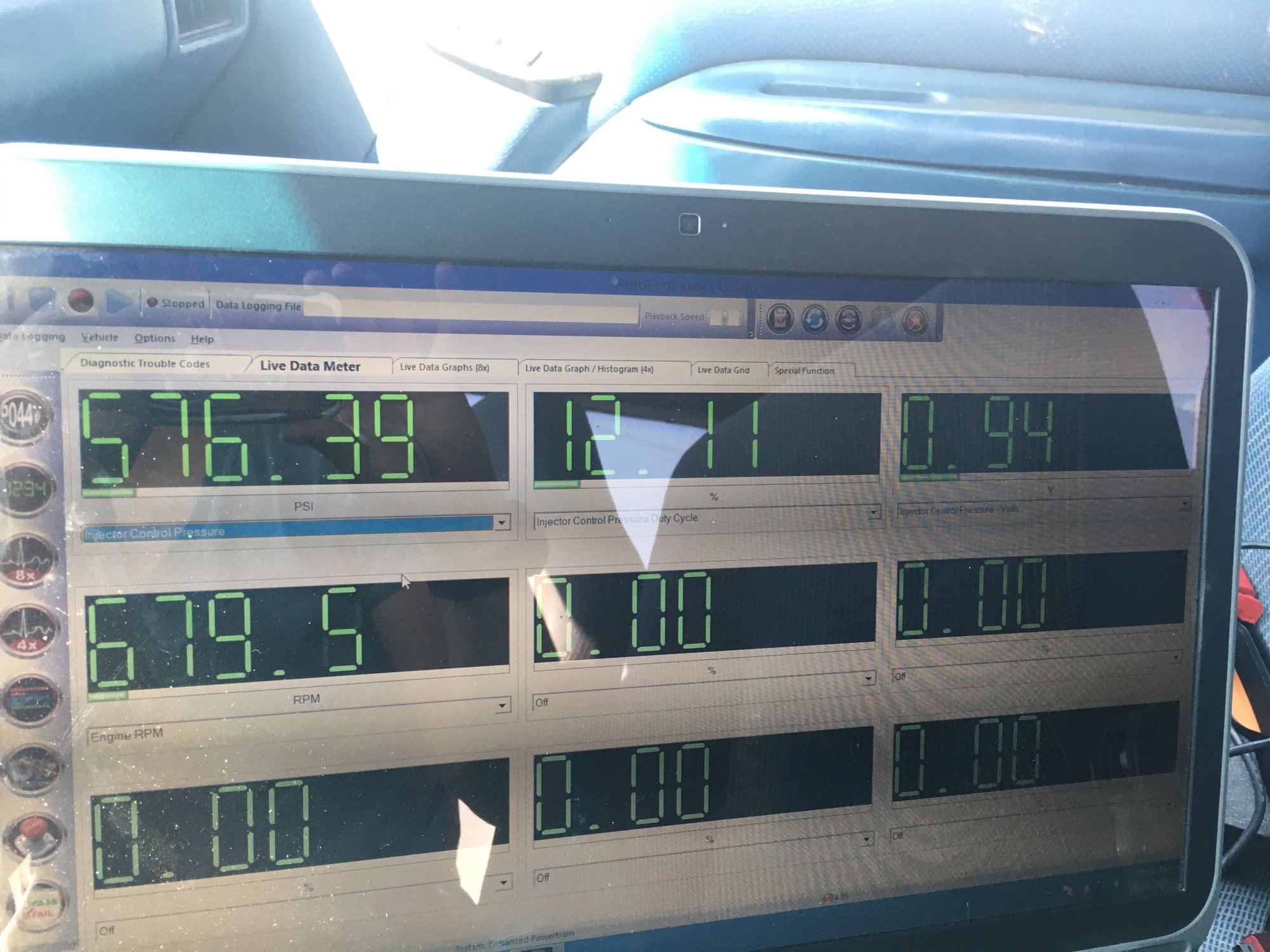

Sorry for not making this one message I get ahead of myself but this is warm idle today. 95 degrees out after 30 minutes of driving

That is actually on the display. Had the girlfriend take a video of the data and I went through and screenshot that

HPOP holding 3000psi at full power with a mild tune seems fine to me. Mine was tuned to do 2700 or so on tow tune, stock injectors. Hot street is 3200, old pump flopped to about 1700. IPR numbers dropped with new pump too.
