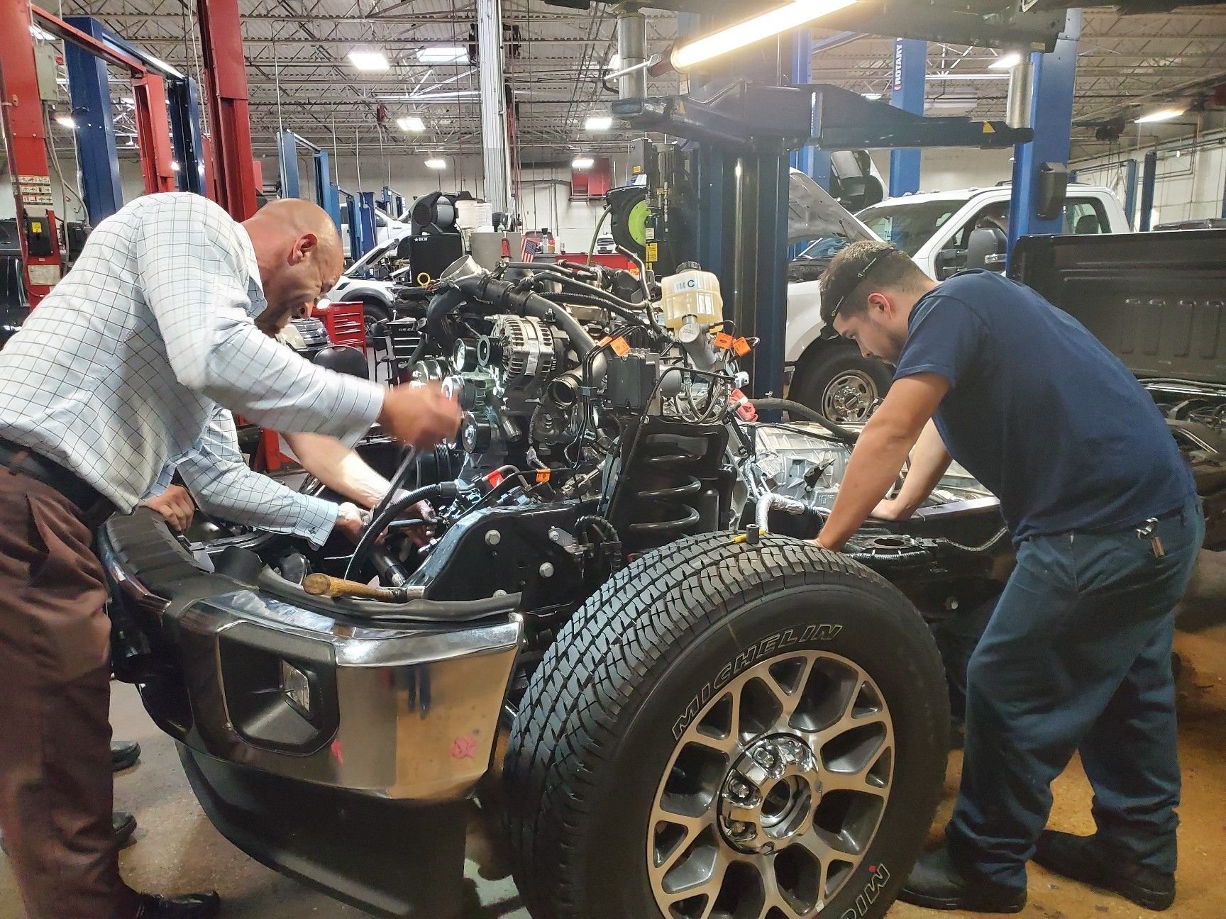

Truck threw a check engine light with 588 miles. It's been in the shop almost a week. Apparently no oil pressure in cylinders 6 and 7 now. For whatever reason, it's eaten a couple of lifters. Dealer has requested a new engine. I took it on a trip right after I bought it (350 miles) and I thought that gas mileage wasn't where it should be... I was right. meh.

That's a real shame. I'm glad the dealer is replacing the engine. I hope Ford (corporate) requests the old engine for analysis, to determine root cause and extent of the issue across all the 7.3 engines. Do you have a time estimate when you can get a new engine? I don't mind if they delay my 7.3 build for a day or so to get you one ASAP!

Likes: 14
From: Seattle area, WA USA
I hope that this one works better for you!
I must say I've never seen a tech wearing cuff links and torquing on an engine before.
LOL pretty sure he's either the service manager or some other guy up the pole. He's a little clean for working in the shop. Wonder if has figured out what that click noise is every time he cranks on that bolt?

Either that, or he's the Ford rep.
