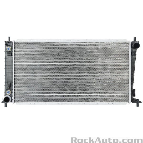

If your transmission fluid is not cherry bright red, but milky or creamy looking, you most likely have a bad radiator. There is an internal transmission cooler line inside of the radiator, surrounded by radiator coolant. If the internal trans cooler line fails (cracks) it will allow the two to mix ( this is bad....). Don't drive the Expy till you pull the radiator out and examine or pressure test the transmission cooler that runs through it. I don't see any transmission fluid on that external cooler picture you posted above, so I seriously doubt that is your problem. If the external tranny cooler was leaking you would just lose trans fluid there, but it would not turn the fluid milky that's in the transmission pan (that you see on the dipstick). Pull the radiator out and replace it. After you replace the radiator, drain and flush the transmission fluid before you drive it anywhere. That milky fluid will ruin your transmission. The heavy duty radiator ( Expy's with tow package...) is a 2 row core radiator for better cooling. You will need to flush your cooling system and your transmission, and change your tranny filter as well.
Expedition Radiators at Rock Auto

If your tranny fluid is milky (contaminated) and not bright transparent red, yes, replace your radiator and flush the coolant system and the transmission fluid and filter. Use new Motorcraft Gold Premium or Zerex G-05 coolant. Maybe a new thermostat too while you're at it.
