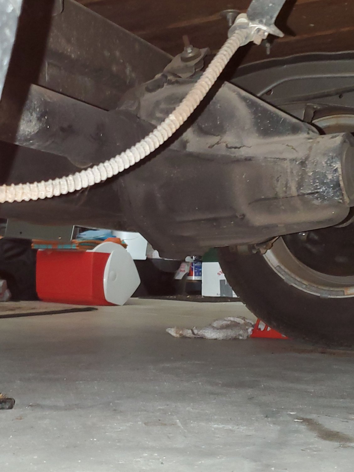

Hey guys, bought my '56 a few months back, and looking to convert rear drums to disc to match the front. I'm not sure what rear end I have. Any tips/links to a resource?
I will post some pics here tonight if there are any experts. I'm not even sure if there is a ID tag on it. Haven't made it that far yet...

A picture of back and front would be most helpful. Also a tag that should be attached under one of the nuts on the cover.

Pics of rear axle
Wasn't able to get under truck to find a tag or numbers. Hopefully someone can ID from these pics...?

It appears to be the original Dana 44 that would be stock for a 56 F100. You can see the 44 on the lower right web, near the axle tube.

It looks to be the stock Dana 44 differential. Here's a link to an article from Wiki that has a picture. Still popular with the Jeep crowd, they were used in 50's Ford pickups until 1956 when Ford went with their own 9" differential in '57
https://en.wikipedia.org/wiki/Dana_4...JeepDana44.jpg
In this link, if you scroll down to the post by ultraranger has pictures showing 9" and a Dana 44 at the bottom.
https://www.ford-trucks.com/forums/1...lp-please.html
