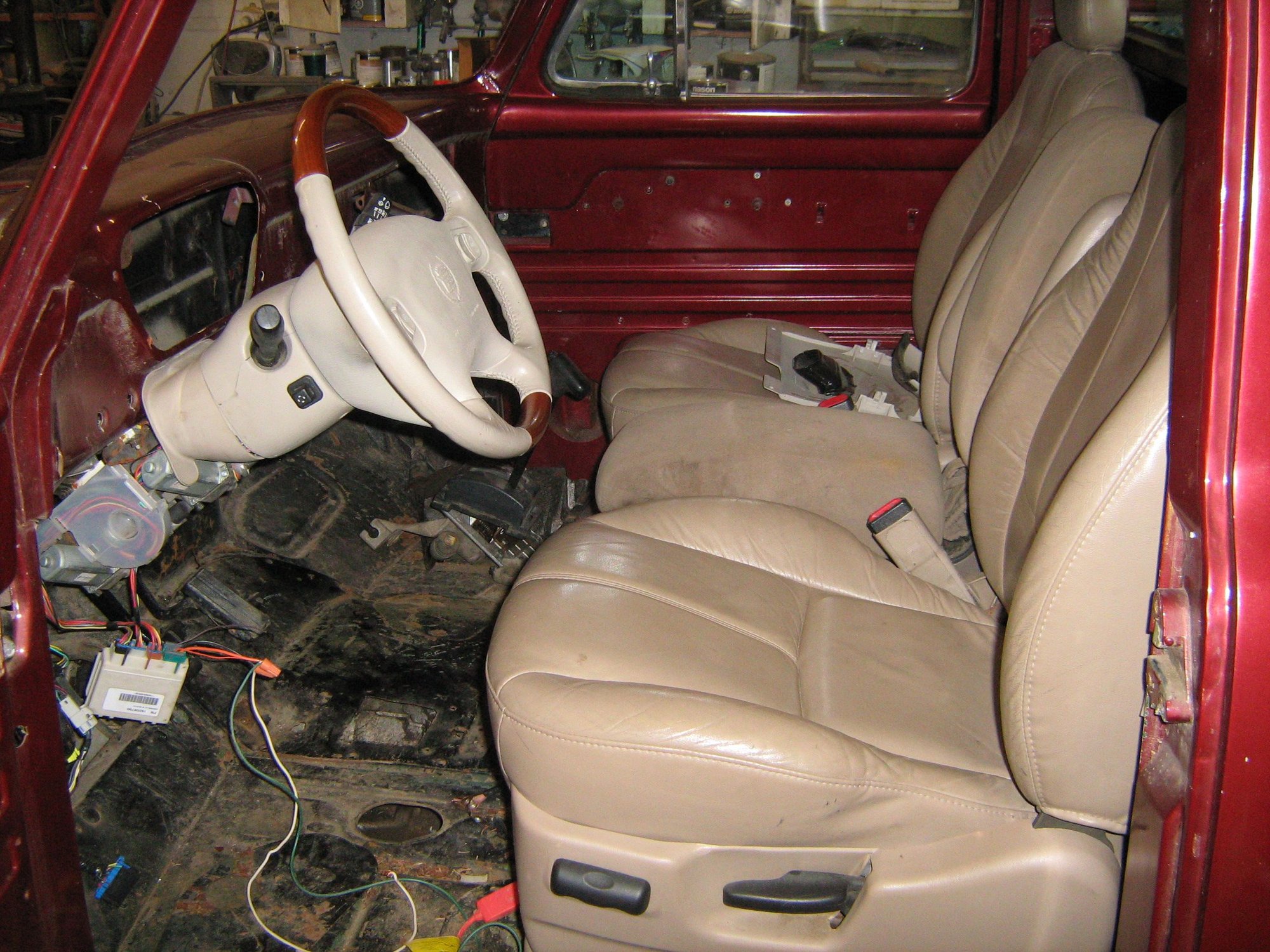

I have not been able to find a seat that would work in my 53. The closest I found is the seat out of my dad's 1996 F250. I still sit about two inches to the left of center to sit in the seat correctly. I am going to narrow the seat. Is there anyone here done this before that can give me information on how they did it? Here is pictures of the seat.

I used 1990 Ford Ranger bench seats in my 48 and 49 but was limited to about 51 inches. The 53 is a bit wider so finding a bench seat to fit in there should not be that hard. I think I would do that rather than try to shorten the one you have.

Narrowing a seat would be a monumental task even for the most experienced artisan . Many have used benches hopefully they will chime in . The gauges in these trucks are situated where it makes it difficult to sit center . Even with my buckets I am a little off center but the option is either very tight to the door or a little off center .

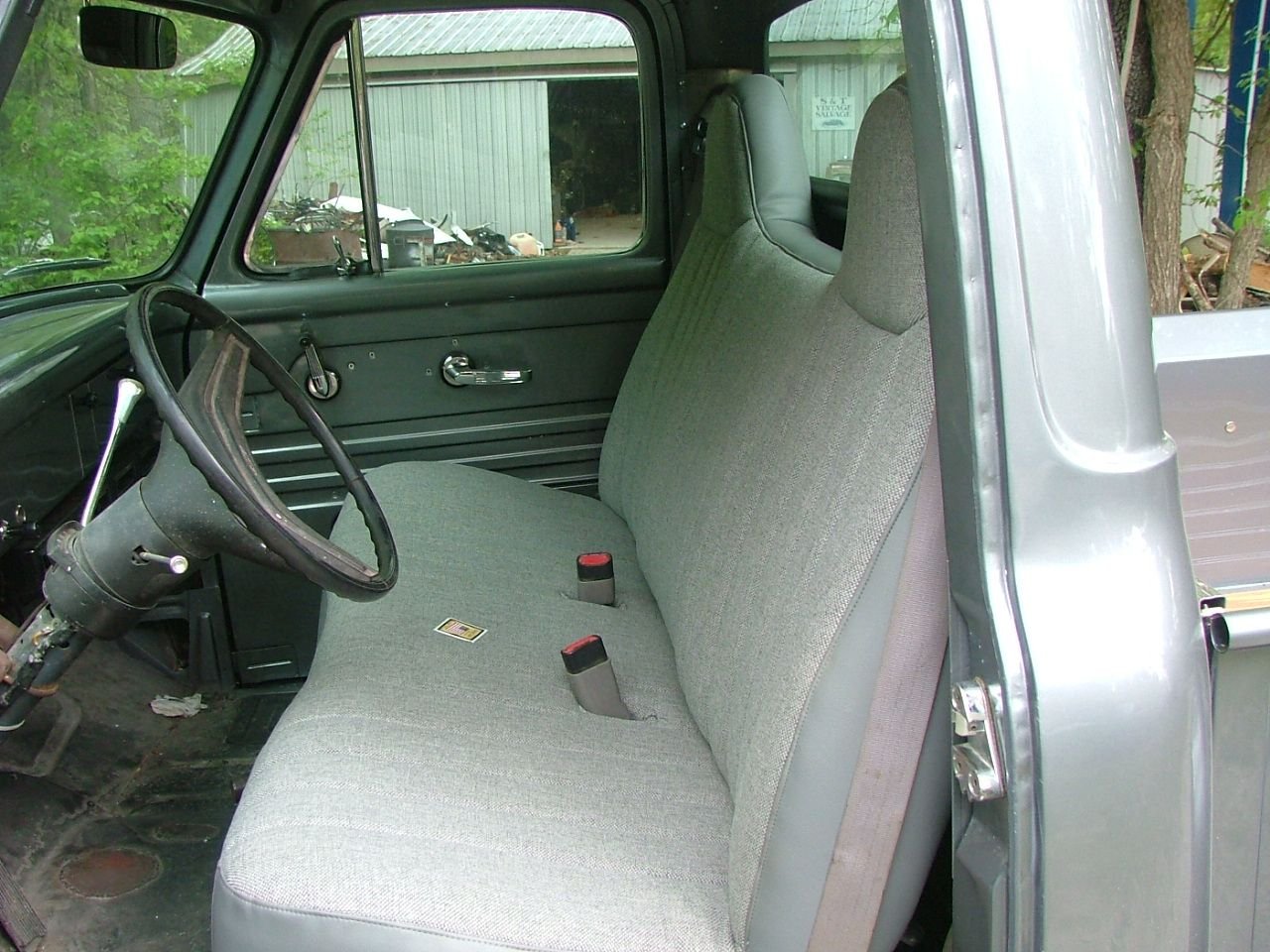

Pappy,. if you just want a common bench seat without bells and whistles a bench seat from a mid-80s Chevy truck fits perfectly... I found this one at a van conversion shop for 50 bucks... little fab work to raise it up and Bob's your uncle
I finally gave it to my body man for his chevy truck and went with buckets

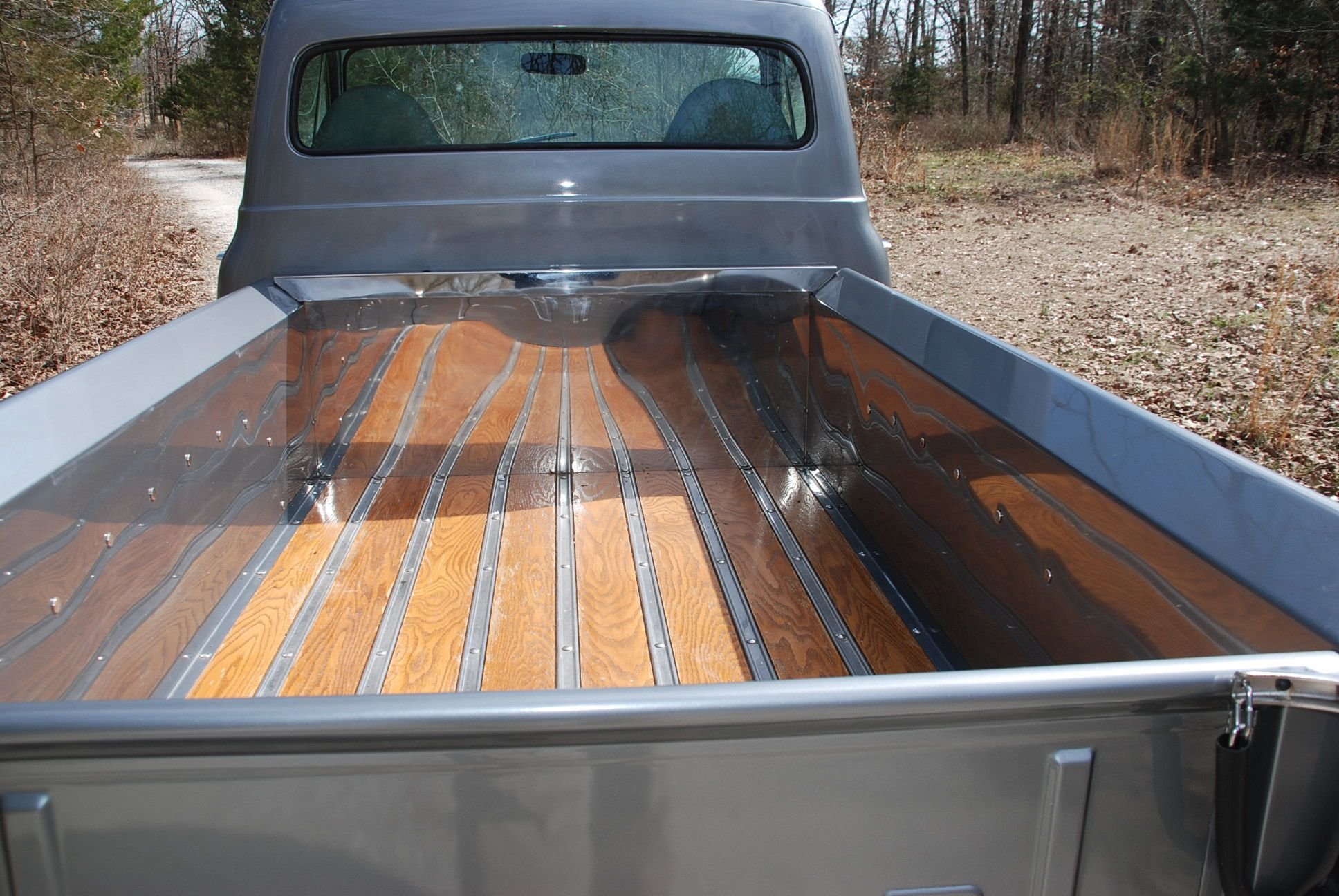

Here are some pics of the seat I used we have talked about before.
As you can see from the front and back views the headrest set toward the outside some but I didn't think looked bad and was not too far off center to be uncomfortable driving

That seat was from a 1999 ford custom, the really cheap truck. The xl and xlt used a different seat. It was off centered maybe a inch or so , but not enough to really be bothersome. If look at front and rear views can see its hard to notice it being off from the steering wheel. I wanted a full seat so could carry 3 people if I wanted too and wanted a head rest to protect my head from hitting the rear window in case of a rear end collision. That seat for filled those requirements and also was a design that was reasonable priced to make a seat cover for. I think if the off center bothered you that seat is a pipe frame and would be easy to remove a inch or what ever you wanted too from the center of the bench and back and weld it back together. I would find a piece of tubing either smaller or larger to insert the cut off ends into and use as a splice to reinforce the welded area..
