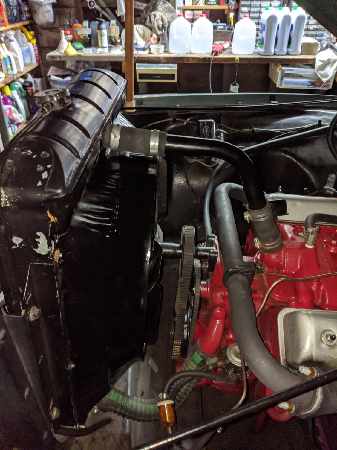

The left side did have a leak after I painted the valve cover but I got that one fixed. I had to take the crossover pipe to a machine shop to get it planed flat. Why the leak popped up on the right side now, I don't know. I guess I better order a gasket set.
About insulating the fuel line, running a rubber hose over the hard line would work, correct?
Here's pics of both valve covers showing scorch marks.
My wife has those clothes pins in the basement. Maybe I can sneak some out to the garage.

Yep, that's the pic I saw of the left side. Didn't know it was old.
I have never heard of covering a fuel line with rubber hose except for chafing protection. Maybe it would work, but I suspect it would attract and hold heat in rather than reflect and dissipate it. The clothes pins don't reflect heat, but they help to dissipate it by increasing the surface area exposed to whatever air flow there is.
