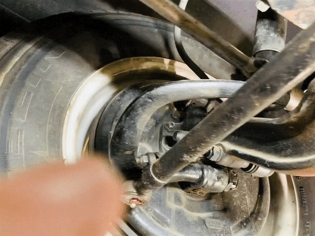

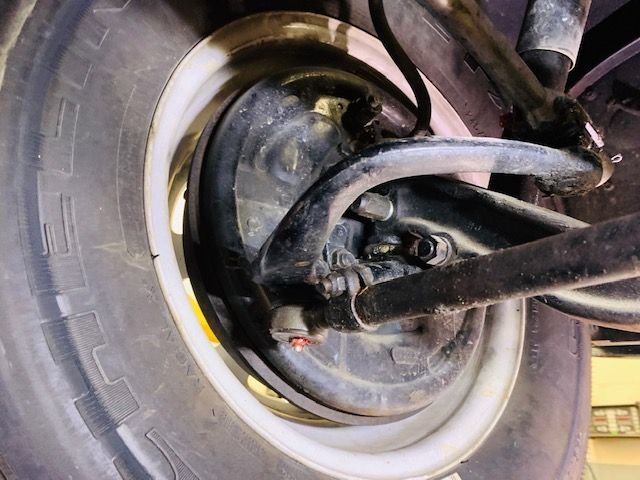

add file of flexing
When they had someone in the truck turning the steering wheel you could see the arm flex up and down but not moving the front wheels. see attached

Hard to tell buy the video whats going on, did you have the king pins looked at? With these old trucks theirs going to be some play with steering & suspension components .... does it wander all over the place when driving it?

Have you tried tightening the nut where it attaches to the spindle?

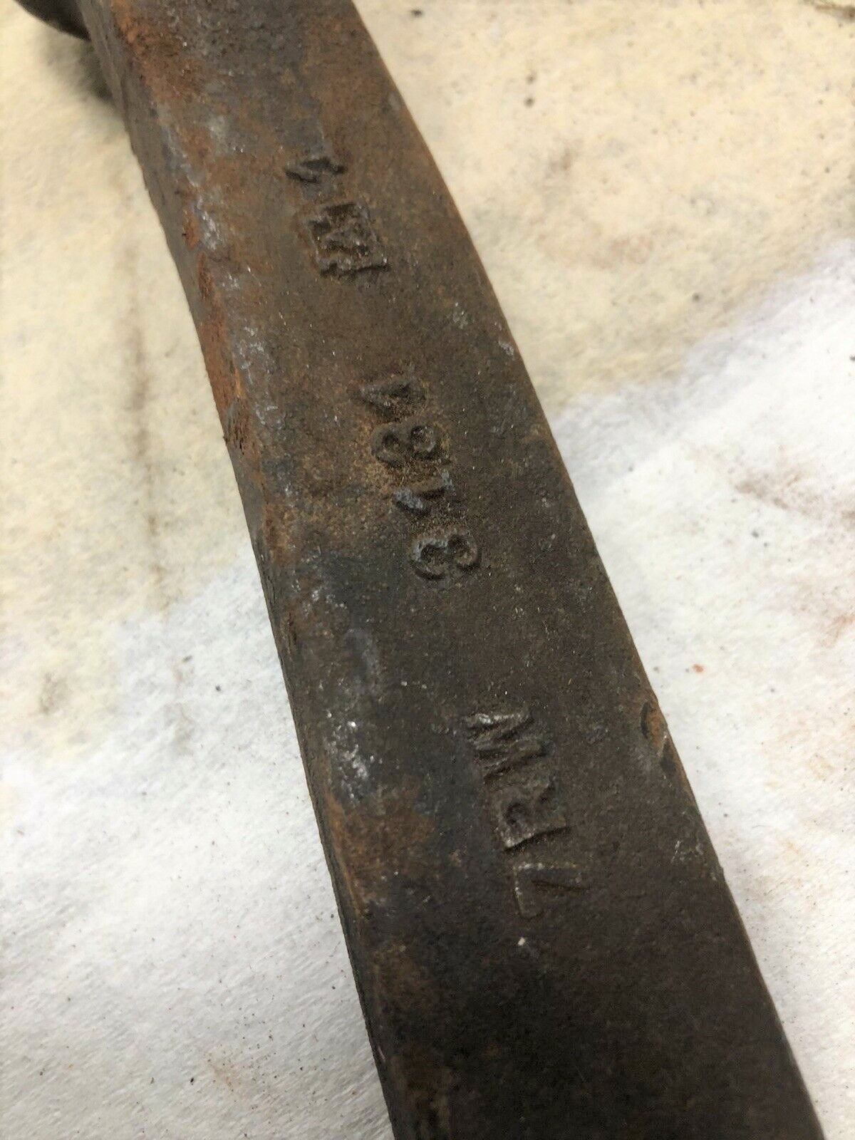

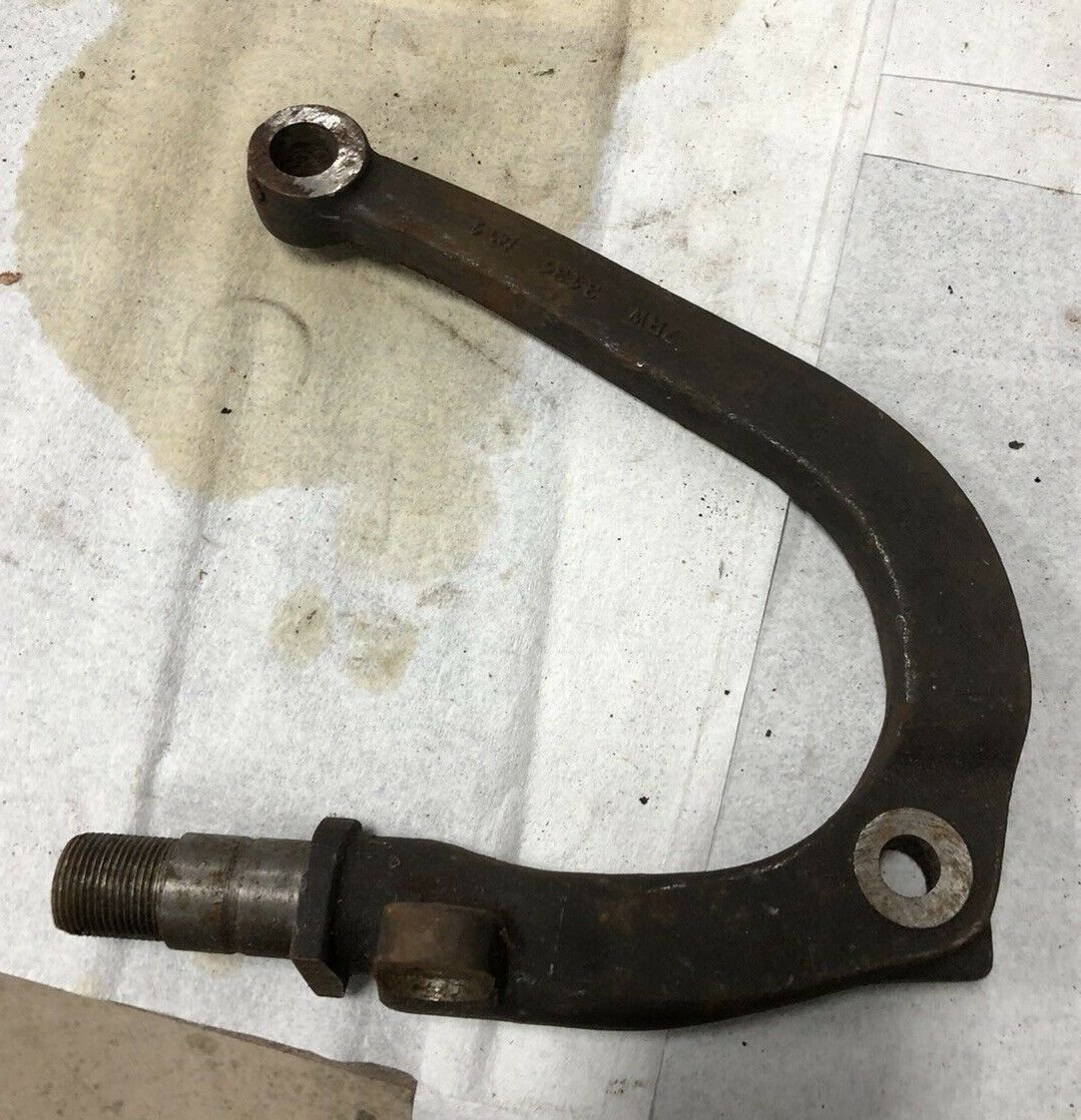

Found spindle arm ... ?
Found the attached arm on the web, looks like what I need for replacement, missing the ball on the end. How does one know if the arm is bad or just the ball.... This story goes on and on

7RW 3131; Spindle Arm LH, 48-52 F5-6 COE and Parcel Delivery. Unless your truck fits this application, this is not the correct arm for you.

By chance do you have a diagram that shows the part numbers. Maybe the arm is OK and can find the ball and cup parts and replace them since I have not be able to find the arm on the web..

F-1 thru F-3 all use the same piece. The ball is welded into the arm on them. I believe some outfits are selling new ***** that can be pressed in after grinding out the old one, then re-welded, but there is no Ford part number for the ball. You may be able to find a new OEM arm with the ball, p/n is below.
Did you try tightening the nut where the arm is held to the spindle? If I understand your previous posts, it sounds more like the whole arm is just loose in the spindle.
