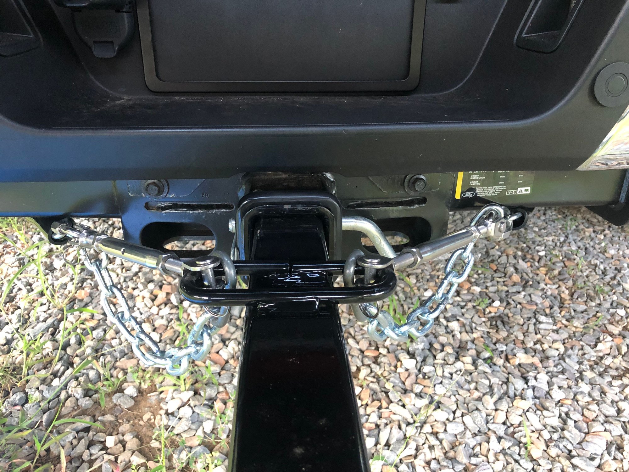

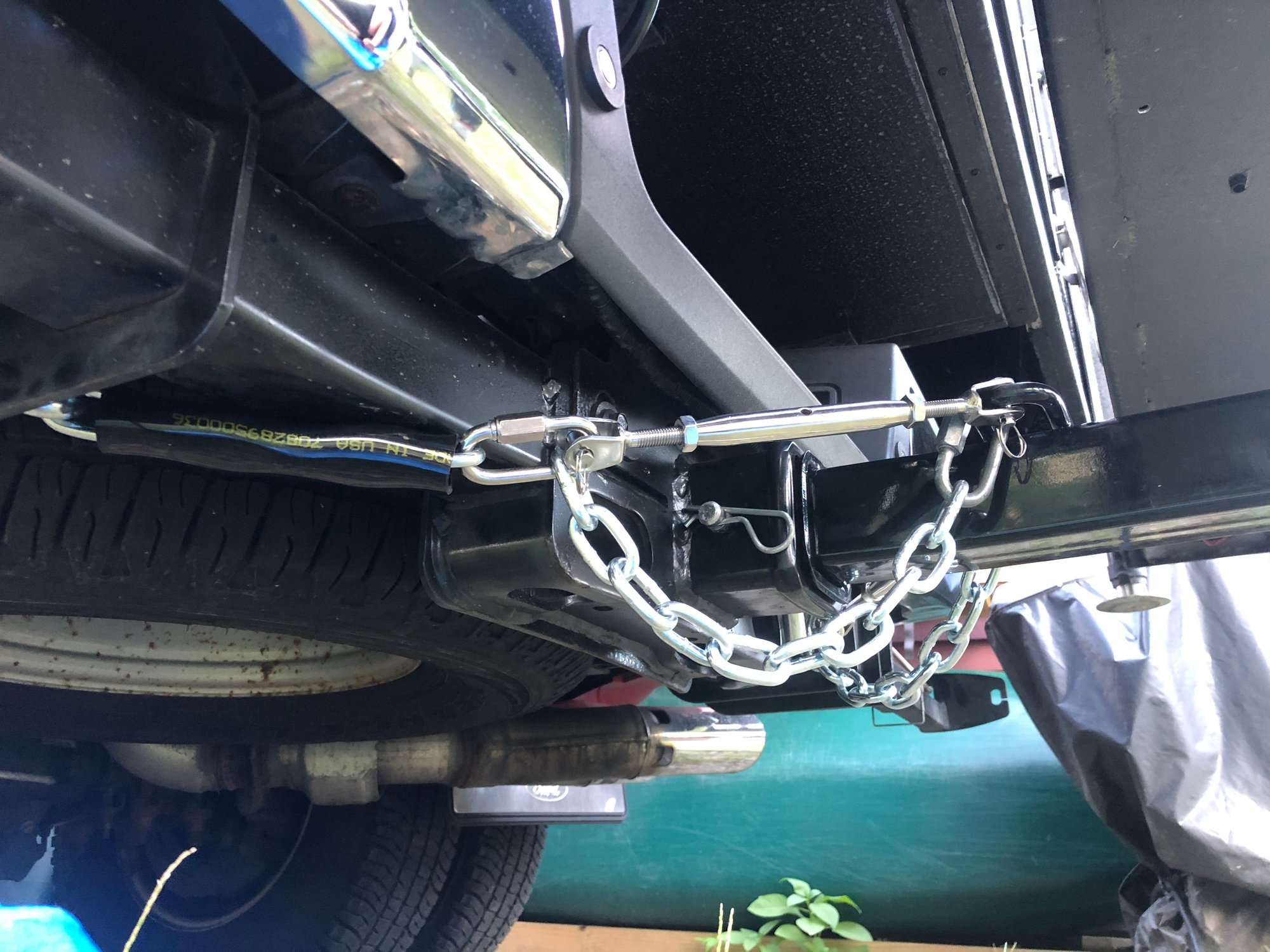

Just use two chains with turnbuckles from the end of the extension to the far left and right sides of the hitch to provide lateral stability. I use that setup to tow my 4000 lb cargo trailer with my 4500 lb camper loaded on the truck. Should be no problem with the towbar as long as you prevent the extension from moving or trying to move laterally.

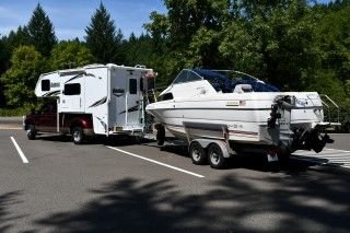

I use a Curt Tow Bar. I've used it on two different pickups over a lot of miles pulling a horse trailer, a boat, when they still had it, the folks 28' camp trailer without any problem what so ever.
I have a square clamp that fits over the tube just in front of the receiver that cinches down on the bar and receiver (big bolt in picture). When it is tightened down and the locking nut secured, the bar is rigid and does not move. The turnbuckles are added security to insure there is no movement.
96 which has been pretty much retired from camper hauling and long bar towing now.

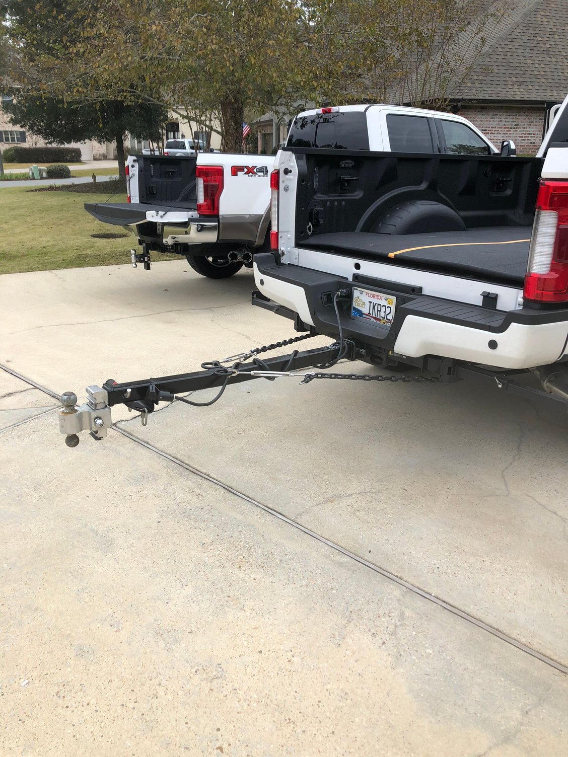

Ended up with the Curt 24”/34” cut down to 24” (6000# or 8000# with weight distribution). Safety chains (5000#/side) to the hitch w/7600# (each) SS turnbuckles @ 45d angle back to hitch (extra chain just in case). Thanks for all the input.
