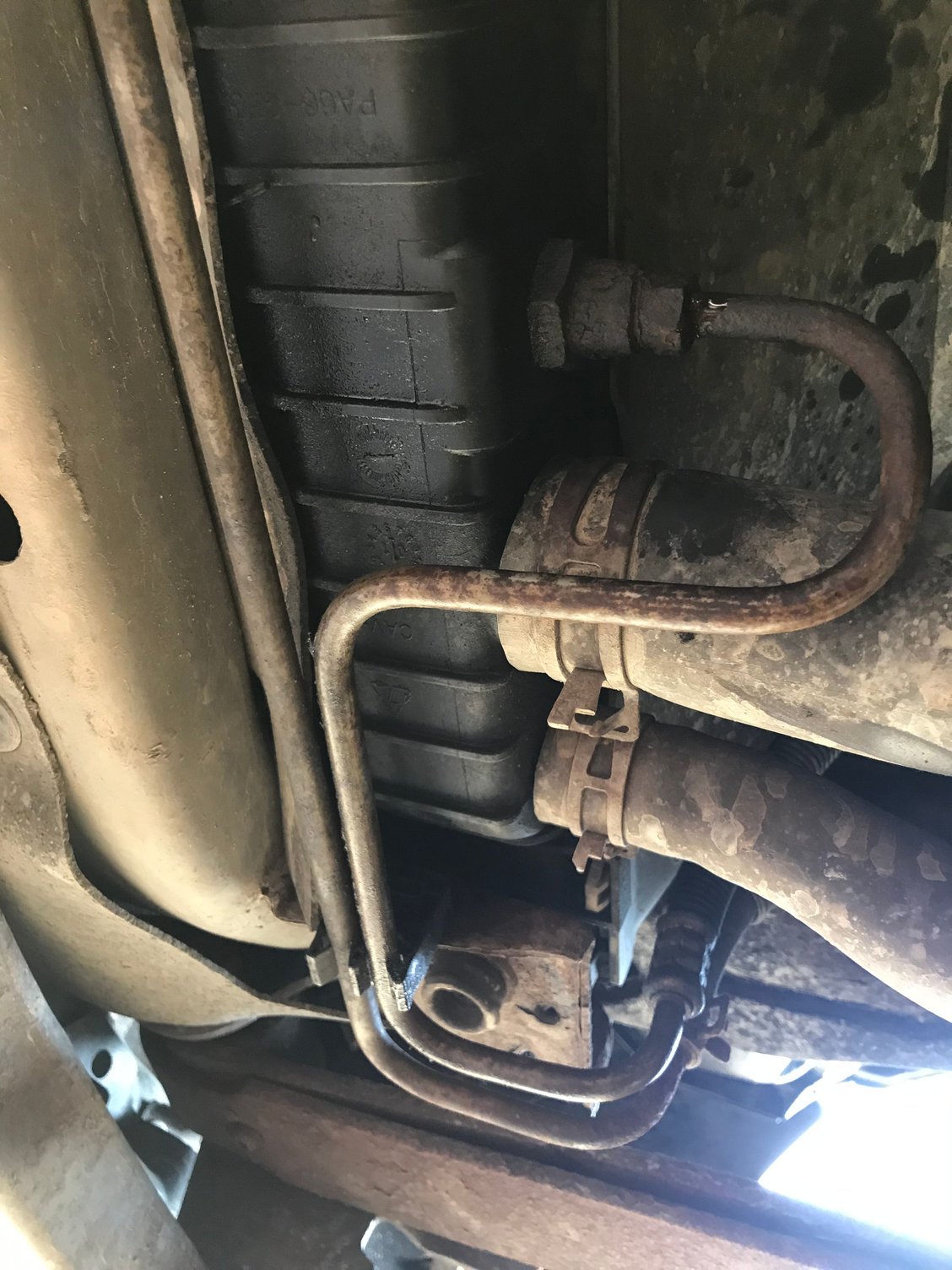

Hey there does anyone know the part number for the fitting holding on this line to the rad? I put in a new steering gear today and then she started pissing oil like a good thing.Ive sourced the lines but no idea where to get the fitting and it’s rusted to pure ****e.
its a 02 7.3 .

The hose comes with the nut at the end. Pretty sure the part the nut screws in to is part of the radiator, not a separately available item.
Looks like a proper sized vise grip would hold it to get the hose nut out. Or 2 vise grips if the nut is crumbly.

no fun when flared fitting crap out

Thanks for the information, I’ve picked up new lines and a rad. It’s taking more money than some classic cars I’ve restored so I’ve ordered a new tundra . Thanks again.this website has been a great resource.
