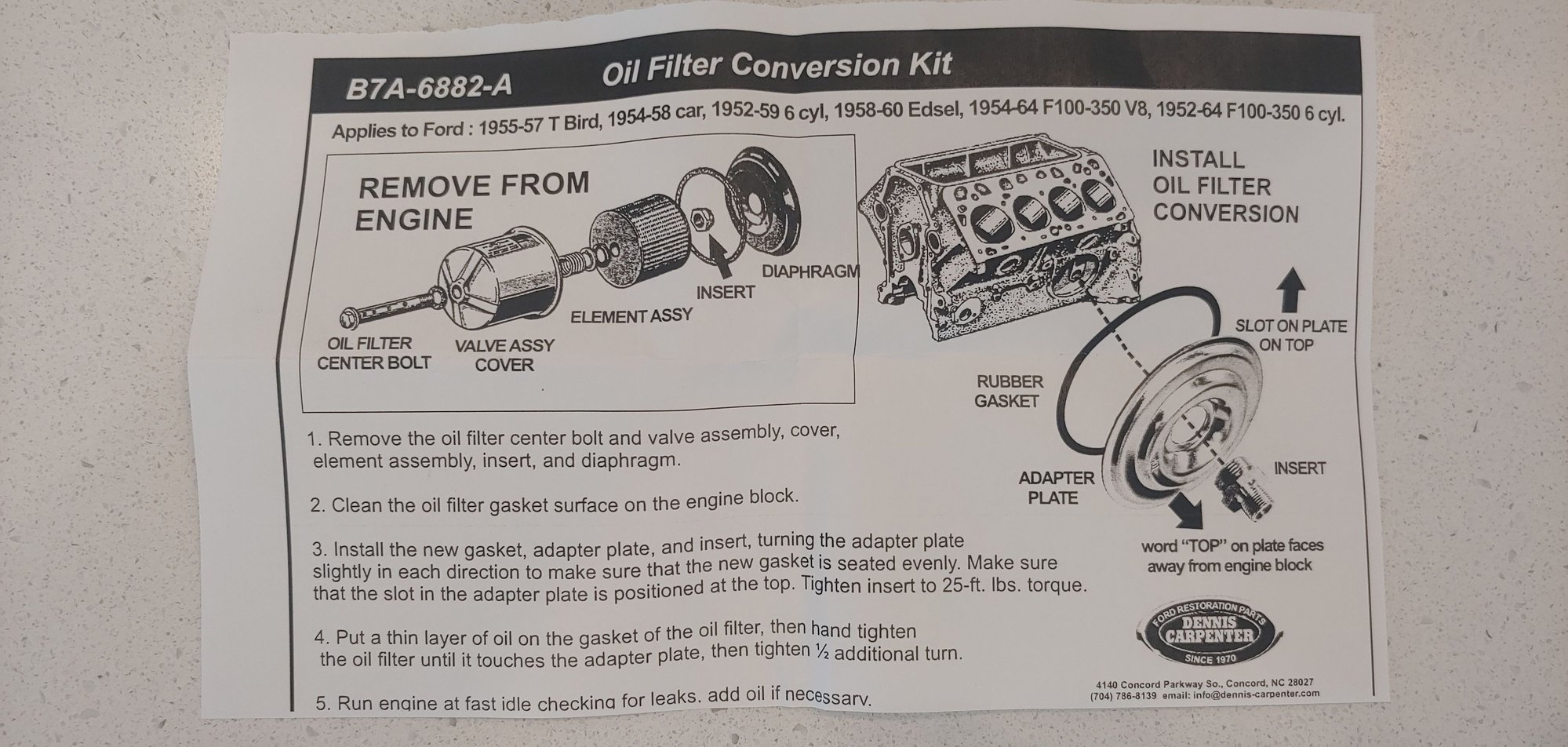

Good morning guys. I am converting my canister oil filter to a spin on from Mid Fifty. Does anyone have the torque value for the adapter plate. 279 lincoln OHV thanks

Thanks John. Called Dennis Carpenter. His guys said he really does'nt know of any spec. Suggested a torque spec like a manifold bolt. I will stop in tomorrow at NAPA machine shop. They are a good bunch and I am sure they will have a good idea.

I have a feeling this is one of those installations that doesn't really have a torque specification. If it were mine, I'd get all sealing surface really clean, assemble the adapter to the block and sung it down. You don't want to reef on it so as to start warping the plate though. It will have to be one of those torque specs where its "tight enough to hold but not so tight as to break" kind of thing. As for the filter interfering, I have the rams horns on a 292 and no problem with the FL-1A. Motorcraft FL300 or Wix 51085 are shorter if it comes to that. Just hand tight is good.

Mine shows 25 ft/lbs.

See there? 25 lb/ft. I even looked it up in my shade tree mechanics handbook, and "snug" = 20 to 30 lb/ft!
