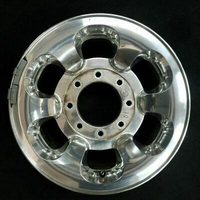

can anyone tell me what the factory offset for these wheels is?

What details can you give us on the wheel? Year, Make, Model?
If my memory serves me right, Ford changed the super duty wheel offset in 2005.
2005+ they used a +46mm offset.
2004- they used a 0mm offset.
