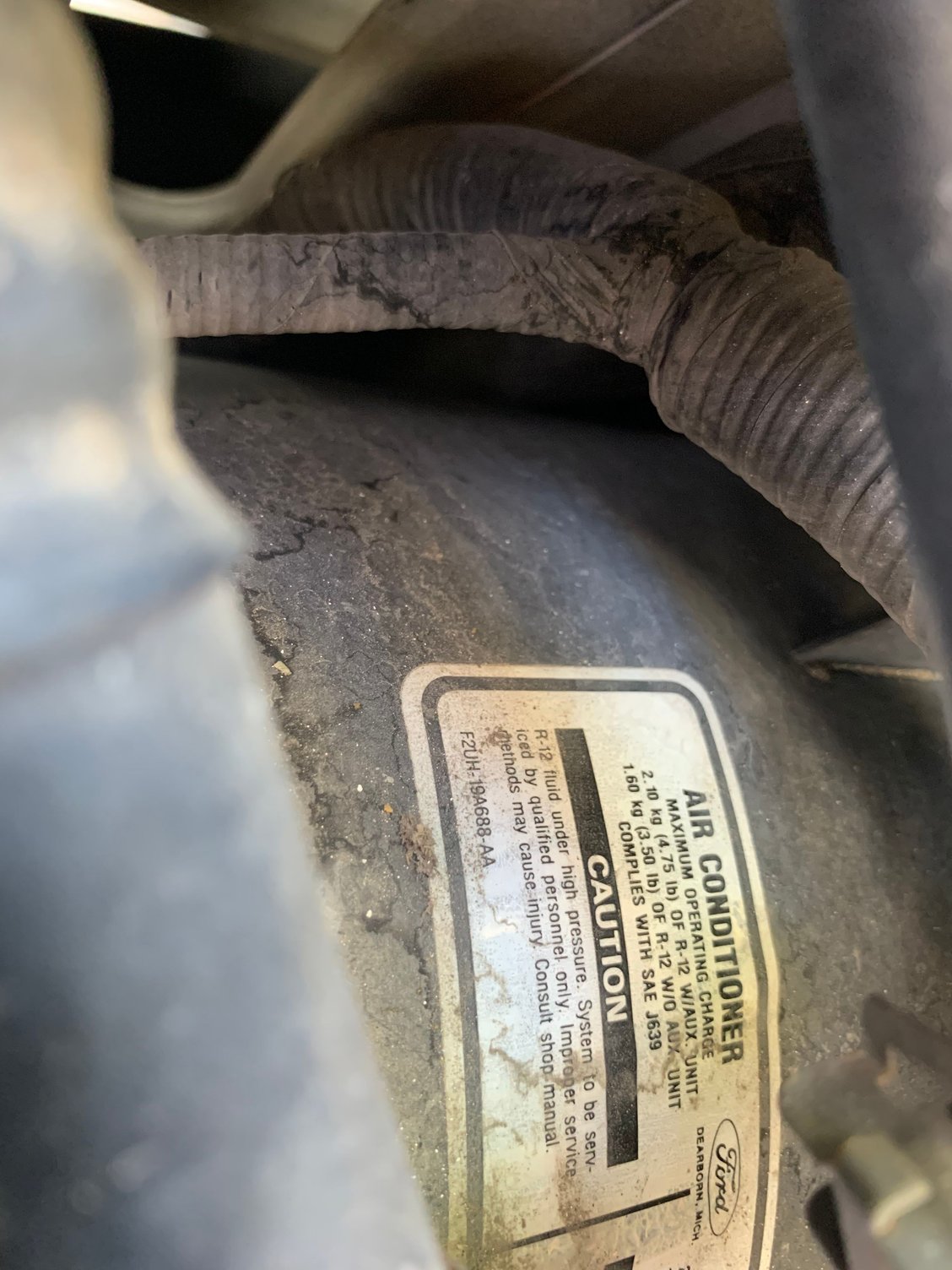

I have an E3 50 Tioga Fleetwood montera motorhome. I’m trying to add our 12 but cannot find the valve. Anybody have a clue?

Welcome to FTE. I'd like to help direct you to the right forum, but I'm not sure what you are asking. "I’m trying to add our 12 but cannot find the valve" what does this mean? What year is the vehicle? What engine size is that? I can't make out what it says on the filter cover.

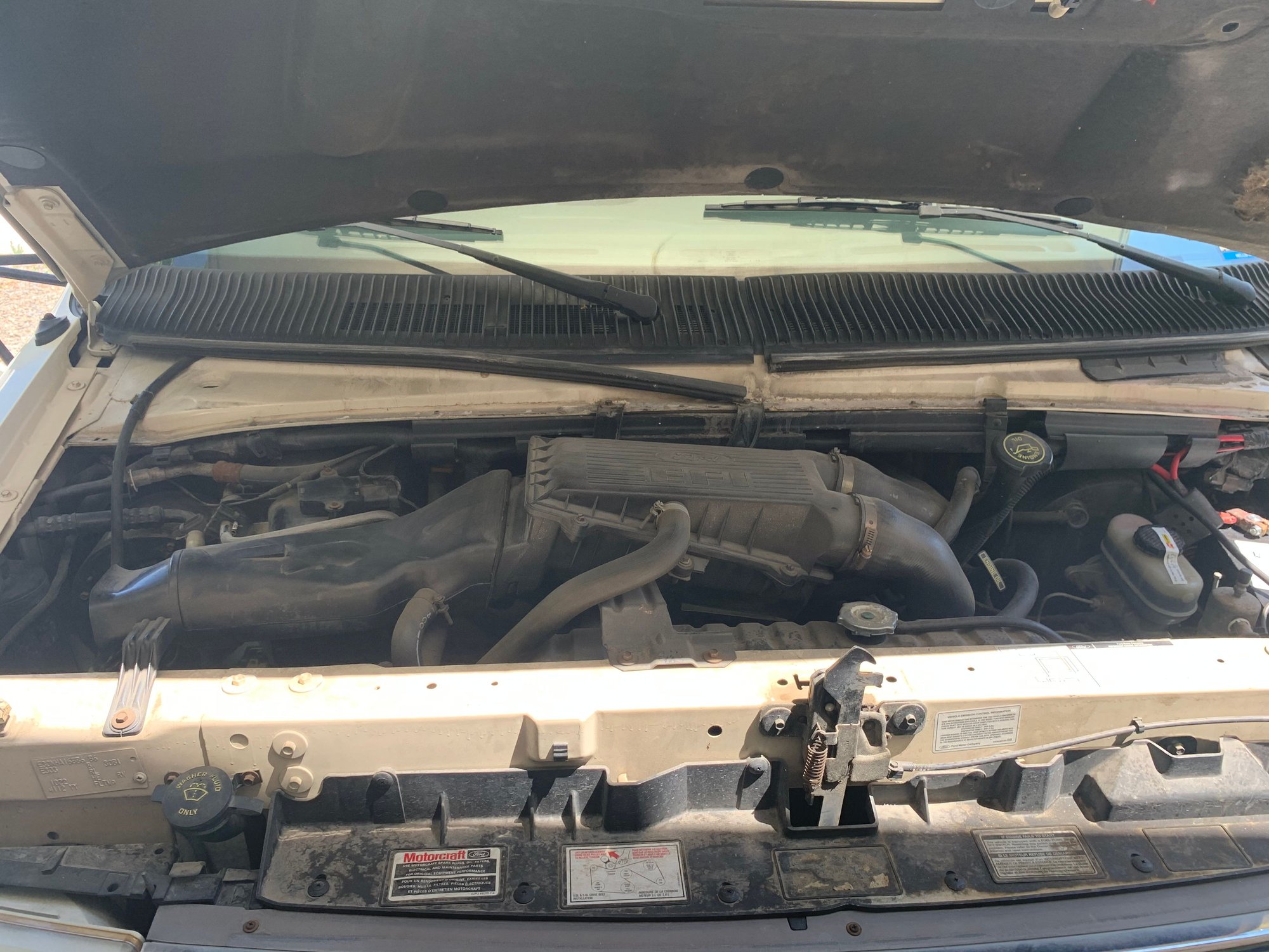

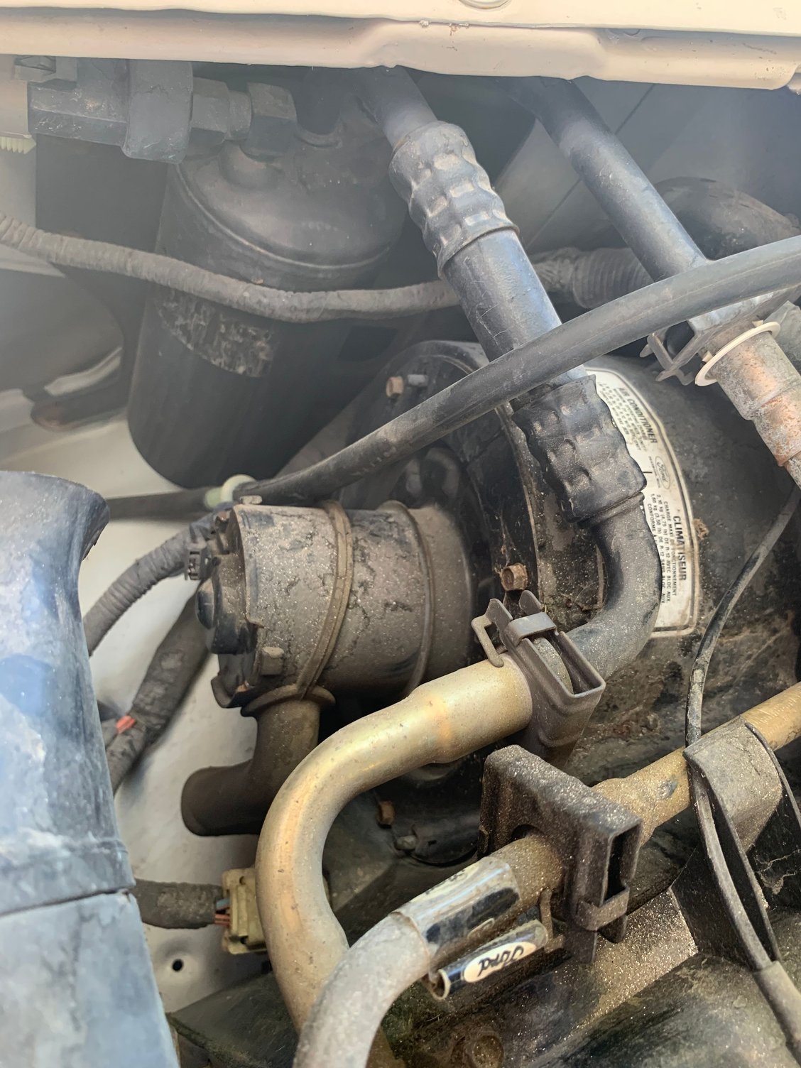

I should have re read my post- R12 coolant is my topic- I have an E350 Fleetwood Tioga Montara Motorhome. AC runs but air is not cool. My first thought is to add the R 12. Which I will have to buy on eBay. But I can’t find the valve to add the coolant. That’s why I posted pics.

Hi, the low side AC port is under the edge of the passenger side fender, just follow the hoses to fender edge. Hope this helps.

OPPS Maybe not,
I just looked at your pictures again and I don't see it. It should be right under the edge of the fender. Sorry.

Valves are likely close to the compressor ...

I used to be a mechanic at a motorhome repair shop and these can be hard to find. as I said before that series of E350 it should be under the passenger side fender edge, but being a motorhome changes everything. One of the hoses should run along under the edge of the cowl from the passenger side to the driver side behind the air filter. Check for the port there, right behind the oil filler cap.
