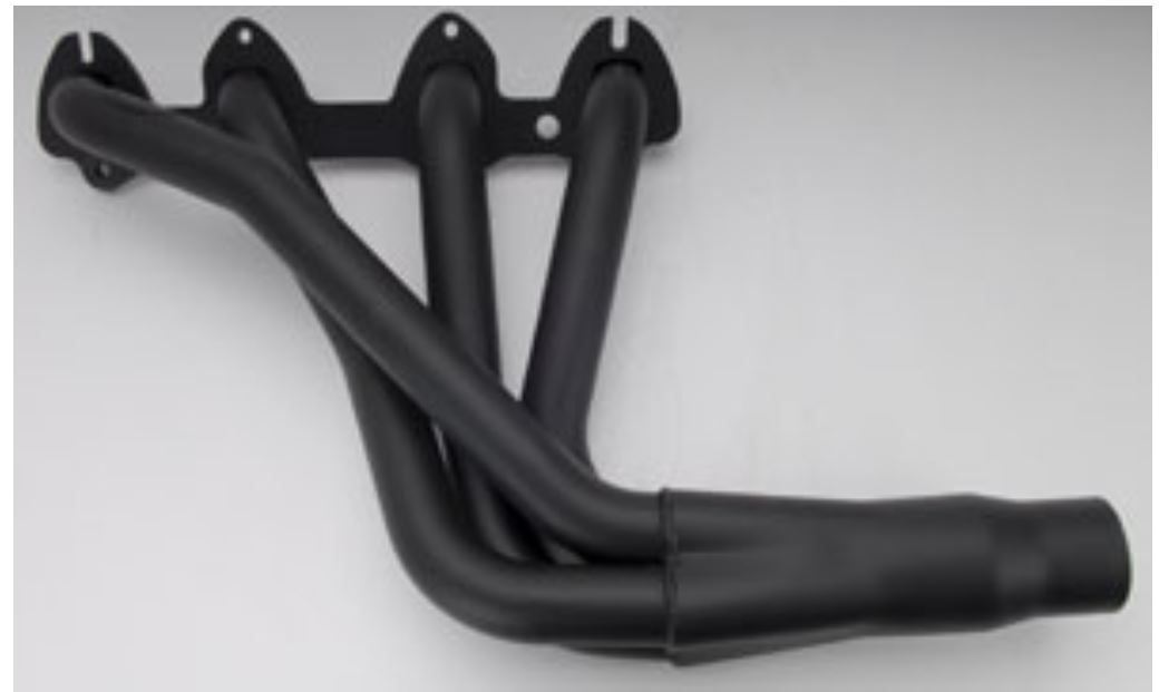

Looking around, the ONLY headers I can find to fit a 390GT head in a Mustang (without modification to the head) are the FPA Tri-Y headers. I don't see any way these are going to fit in the truck unless you cut them apart. Maybe FPA will sell you the flange and you can make something of your own with another set?

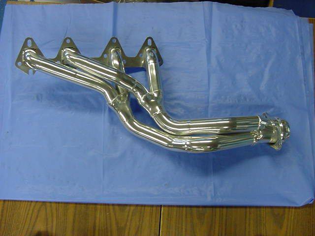

here are the Hooker long tube headers I have in my F100 with a 390 for comparison. I think the GT headers above would probably end in the firewall. That said I'd give the FPA people a call and see what they think.
Page created by PaperPort's Microsoft FrontPage Editor Link
Thank you for good help.
I have sent mail to FPA but only get answer that they don,t make headers for truck anymore.
