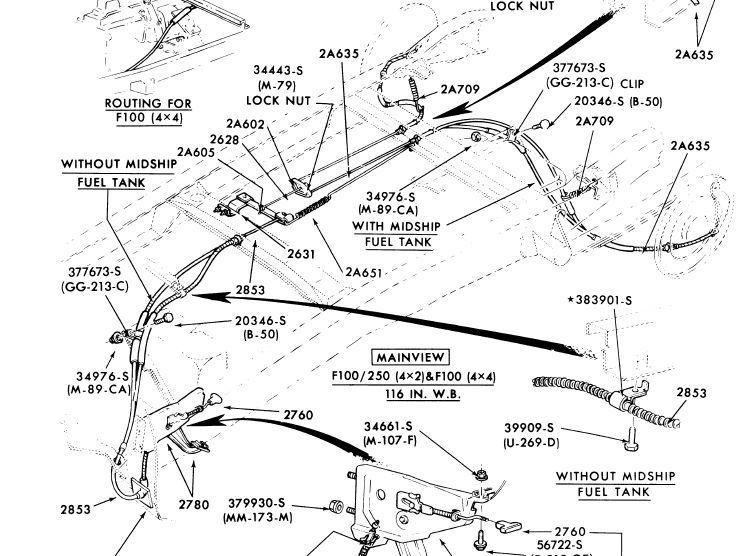

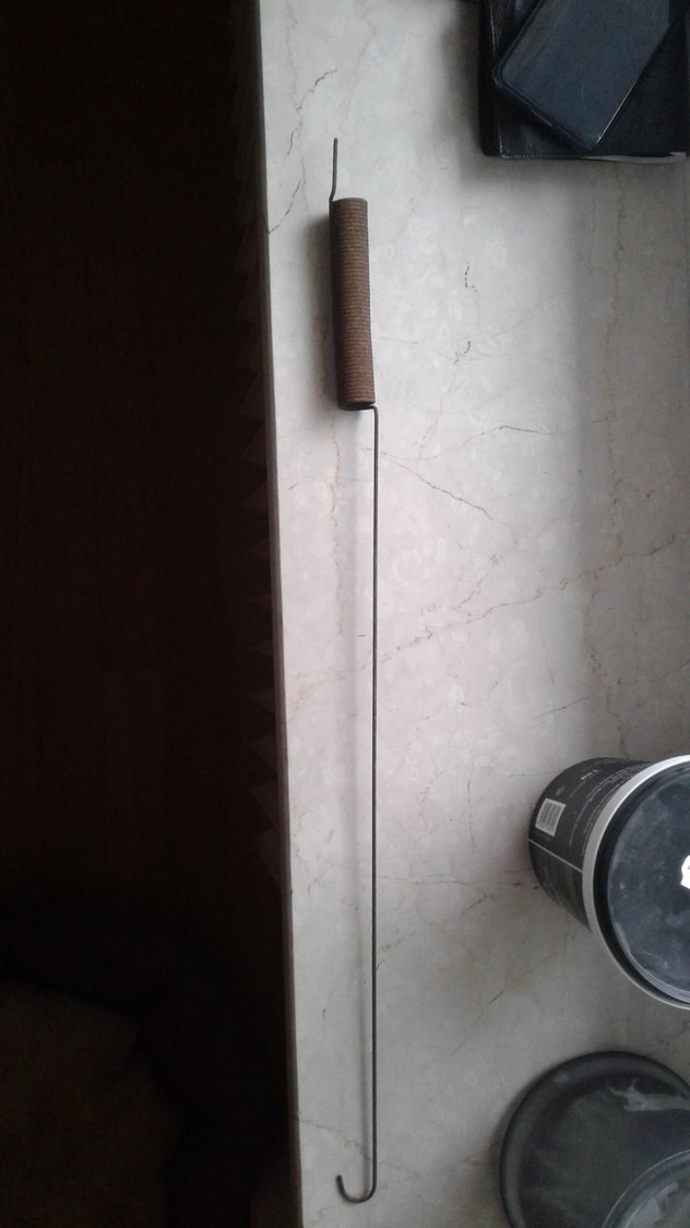

Anybody know where this spring goes? It's about 23 inches long and fell of the undercarriage of my 77 F250. I was thinking that it might go to the parking brake cable?

Yes looks like the tension (pull back) spring. When you set the emergency/park brake that springs gets stretched out. And when you release the brake, that spring pulls back on the cable going to the cab. The bracket set up in the diagram is for a 1/2 ton.
Thanks! I thought that's where it might go, but i didn't even know it fell off until my buddy brought it back to me yesterday.

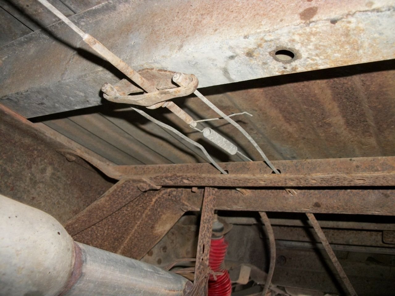

Best quick guess I could give you, time to get under there and look around.

Does anybody know the correct name for that particular spring and where i might find one? I looked on lmc and rockauto, but didn't find one.

NPD calls it Spring, parking brake equalizer. And no they do not have any for sale.

I picked mine up from the "HELP!" section from autozone. They sell it as a general spring, I just cut the one side off and bent it too my length. They have a few different sizes.

Ditto on fordguy2100. Maybe this will help. Ebay maybe?
Part number is 29003
Bend and cut to fit.
