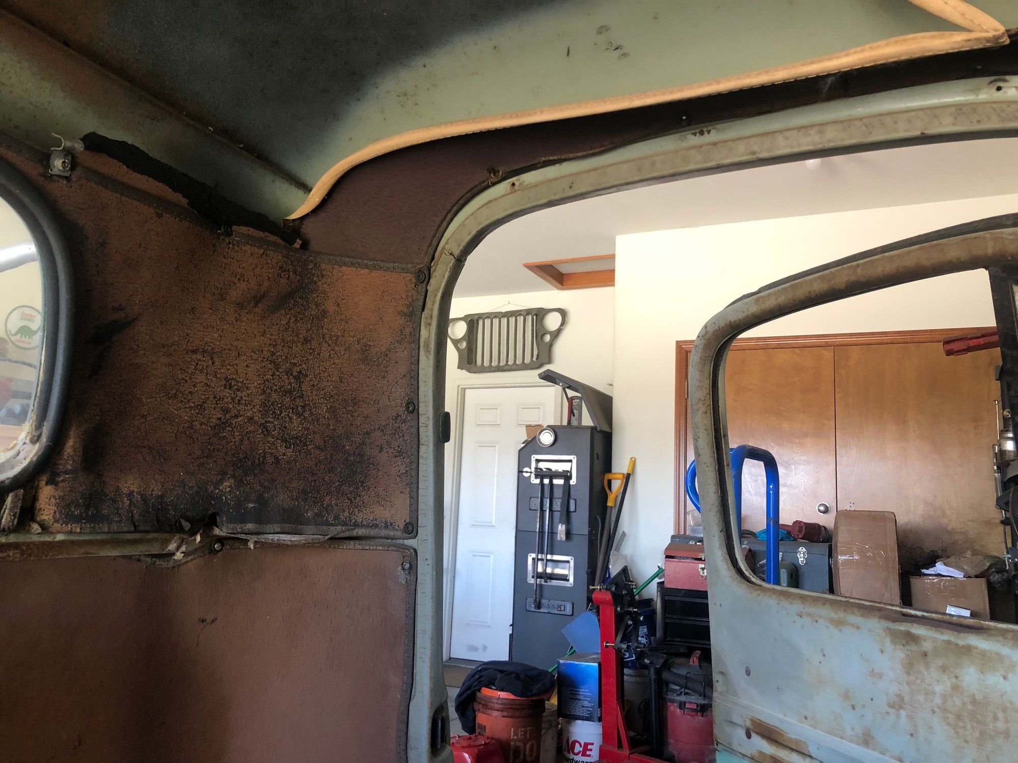

Does anyone know what the purpose of the dip in the top edge of the left and right below rear window panels
is for other than exposing part of the cab?

It is supposed to go behind the hat channel to hold it in place along the back wall.

Thank you for the picture, that explains it

It was only tucked behind on early 1948's. The rest of the time, the dip was still there, but the panels were installed like you have them.

I guess mine could have been changed, but it was tucked behind the hat channel when I removed it. It’s a ‘50. All the pieces were there and the hardware was stock, so I think that’s how it came from the factory.

In a truck that came from the factory with the panel tucked under at the dip, there would not be a hole under the center of the window for the screw. There are lots of variations in the way the different assembly plants did things, though. Most of my trucks came from the middle of the country to the East, so a little detail like this might have been different on the West Coast.

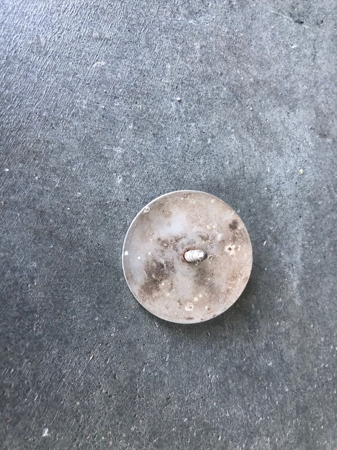

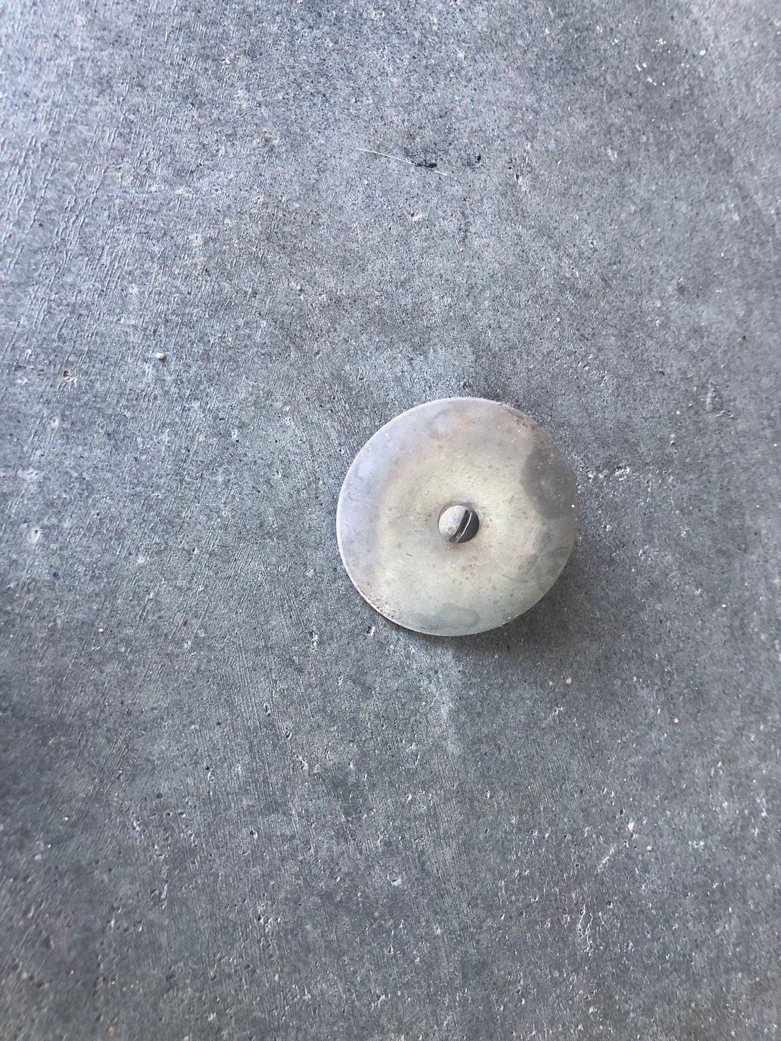

Since we are discussing headliners, is this the correct screw and washer for the center roof fastener?
