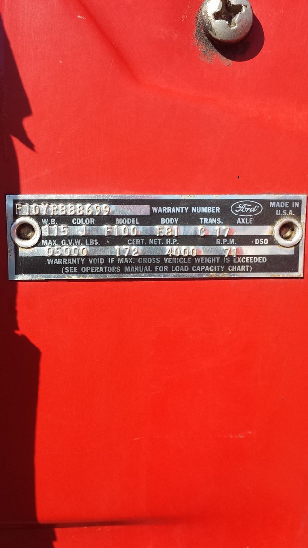

What's wrong with this picture?

It looks to good.

Horse power should be 208 at 4400?

I can't find anything wrong with it.

05000 gvw seems like a light weight Chevy. Can also see red dots on it. Rivets possible not original. 888699 seems pretty high. Very late August 1966 build or maybe it was intended to be on a 1967 model. Colour looks more fire signal red code 5 and not Rangoon Red code J.

X2! Looks good to me also.

I know! The Vin # has a winning poker hand.

Only thing I think is wrong is I don't see it in my driveway . .

Com'on guys! There is a zero in front of the 5000 GVW

This is the GROSS HP & RPM .. Warranty Plate only has the NET HP & RPM = 172 @ 4000
5,000 lbs. Gross Vehicle Weight Rating was the highest rating for 1965/66 F100 2WD Regular Cabs.

?Didn't all of them have the same. Every one I've recorded so far has a 5 digit GVWR with a leading 0 if is is under 10,000.

I do not recall seeing a zero in front of the gvw. I will have to look at all my doors tomorrow if the rain backs off. Gotta find my gumbies sooner than later. I also sold my roto molded kayak so I am making lots of mistakes this year for the weather.

RangerMercMan is right, as usual.
You are looking at original paint, and it is certainly not "J". (The plate is original and correct in other respects.)
I want to paint a replacement door. Should it be signal red, poppy red, or?
Eric

05000 looks good to me, 66 F100:

Ok ok. There seems to be a goose egg in front of the 5 on VIN plates that I have seen on this forum. I guess I got used to ND's decode and reading 5000 GVW. 6t6merc says I won with the paint code though so tongue 👅 out lol!
