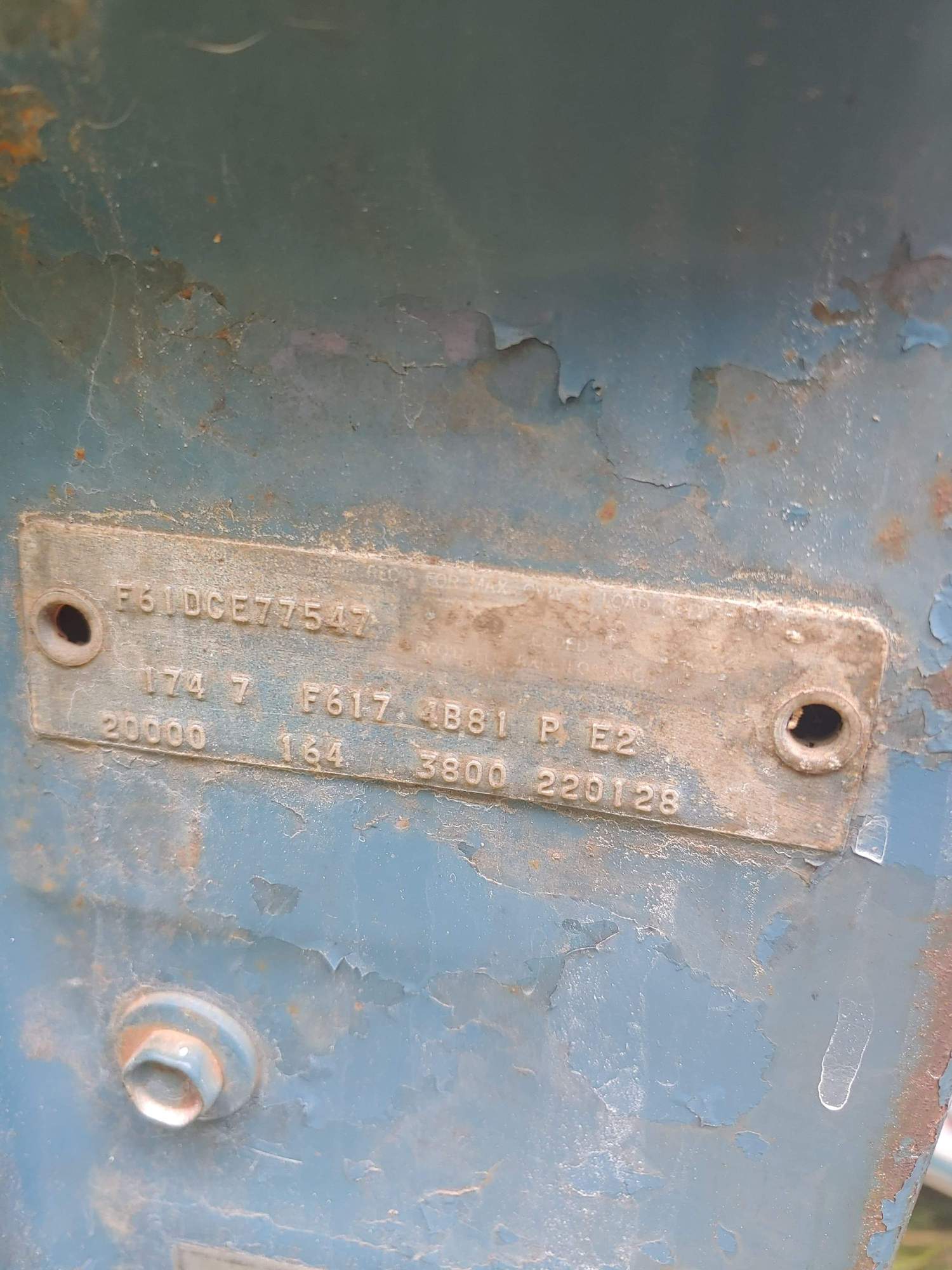

New member, but hope to be on here more... I am looking at a 72 F600, and could use some help decoding the door plate (trying to sort out just what I'm getting myself in to). Thanks in advance!
My reading is as follows (in case picture is a PITA):
F61DCE77547
174 7 F617 4B81 P E2
20000 164 3800 220128
F61DCE77547 // WB: 174 // COLOR: 7 // MODEL: F617 // BODY: 4B81 // TRANS: P // AXLE: E2 // MAX GVW LBS: 20000 // CERT NET HP: 164 // RPM: 3800 // DSO: 220128
F61 = F600 (gas).
D = 330 2V H/D FT engine.
C = Oakville Ontario Canada Truck Assembly Plant.
E77547 = 1969.
174" Wheelbase.
7 = Dark Blue.
F617 = F600 (gas), 20,000 lbs. GVWR
4B81: 4B = Black all Vinyl // 81 = 81A Standard Cab.
P = Warner T-19 4 Speed Fully Synchronized Manual Transmission.
E2 = Eaton model 16244 Two Speed Rear Axle // 6.17/8.58 // 17,500 lbs. Rear Axle Capacity.
20,000 lbs. Gross Vehicle Weight Rating.
164 net HP @ 3,800 RPM
220128:
22 = Charlotte NC Ford District Sales Office, where the original selling dealer ortdered the truck from.
0128 =Domestic Special Order number, truck ordered special by the original purchaser, not "bought off the lot."
