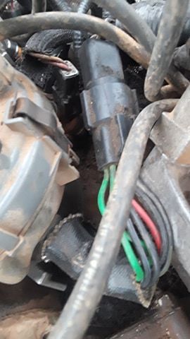

Thank you....to kind of show you the difference in what I'm working with.....the first picture is the 1992 and the 2nd and 3rd picture is the 1990.

The picture below is the earlier setup that Ford used. The ignition module that turns the coil on and off is mounted directly to the distributor, it's the rectangle grey looking piece that is bolted to it and the wires plug into. They had problems with them getting too hot, so later on they moved the module off the dist and mounted it somewhere in the engine bay on a heat sink.
So I am assuming you just swapped the whole complete distributor? That should get you going, if you get it in the engine correctly Put your testlight or voltmeter on negative of the coil like you did before. You got 12v on the negative. As you crank the engine over, the testlight or voltmeter should start blinking, that is the module turning the coil on and off.
If I were you I would swap what I could off the newer engine onto the older engine. There are some sensors that are probably in different places, and the later engine might even be mass air, you will need to swap all that over also. Just swap the entire top dress of the bad engine onto the good engine.
