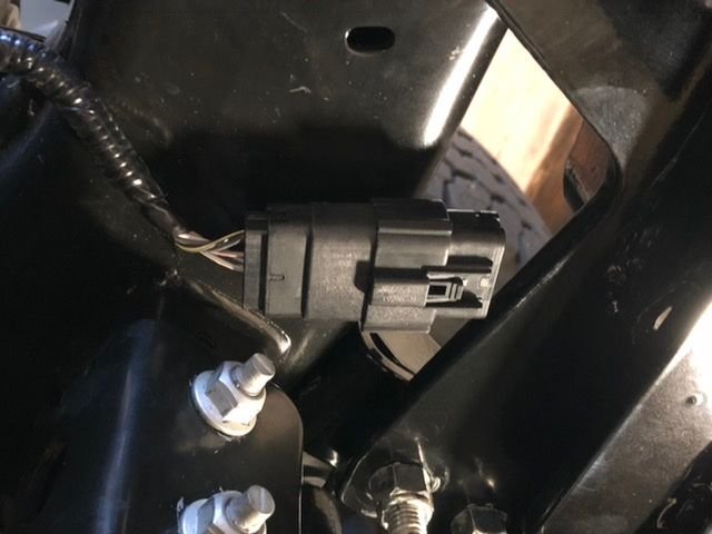

What is this plug?
2020 F250. D/S lower front frame area. Truck has snow plow prep. I thought that plug may be related to snow plow prep, however I just got done putting Western brackets and wiring in my truck and that plug or wires were not utilized. (figured a way to get my mind off July heatwave was to think of snow).
Here is photo of plug in question:

What trim level is your truck?

It's an XL with STX. 6.2/6 speed

Fog lights.

My first thought would be fog light connector do the STX come with fog lights? If yes then that's not it. That would also mean you would have 2 of those connectors, one on each side.

I do not have fog lights. I am pretty sure I do not have this plug on the P/S unless it is in a slightly different location. But fog light plug makes sense for this. Wonder if these wires go into the cab somehow and are just unused behind the dash where a fog light switch would connect.

Yep, I have the same plug on my STX. Maybe one day I'll find a cheap take off fog light bumper and buy the proper headlight switch.

The fogs might only use/have that one connector...
