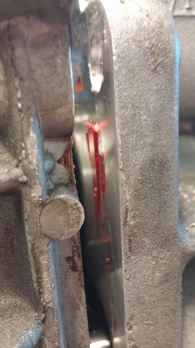

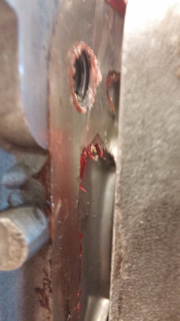

The 3550 is a very decent transmission but very prone to leaking. Google it. Mine leaked brand new before the car was off the jacks. When I took it apart at the halve's it had nearly no "Anerobic" sealant see photos. Bought the sealant and resealed it hasn't been a problem. The other issue is at high revs they don't want to shift too well but for what your doing it won't be a factor. In your truck it will be a great upgrade. You didn't mention what engine you have so sourcing a bell housing may hinder your progress. Mine is mated to a 460. You'll also need a drive shaft
