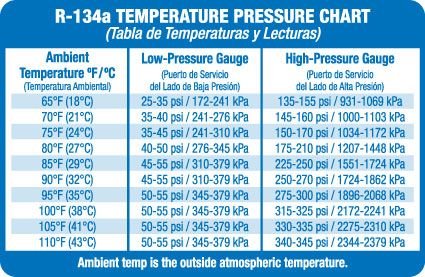

At 85 degrees with the engine running and A/C on Max/recirculate you should see 45-55 psi on the low pressure gauge and 225-250 psi on the high pressure gauge. At this point the system is full, and if you add more refrigerant the system will quit working. Good luck, Russ
