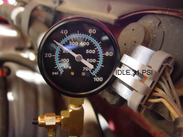

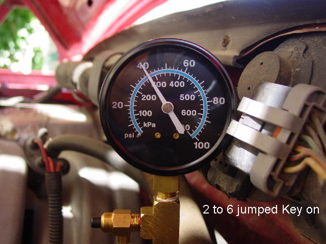

2 to 6 jumped key on engine not running.
Attachment 281589
Engine at idle 2 to 6 not jumped.
Attachment 281590

Rented the gauge
Rented the Gauge and either there is an issue or maybe I did this wrong I'm not sure but I did what the book said and I got no more than 10 lb of pressure and then I tried to do the engine running and I can't get a reading on the at all. So I tried the not running test again now the gauge won't register lol I saw something with the self test plug what's up with that

I used the test gauge today and the pressure was right now I did not use the test plug I did the test without it running and then test with it to the floor I did not need the plug right the test plug because if not My fuel pressure is fine

I've had fuel pressure measure within spec in the driveway, but fall precipitously while driving. In my opinion a fuel pressure test is not complete (and thus not very useful) if you don't measure the fuel pressure while you're having the symptoms that lead you to do the test in the first place. Typically this means taping the gauge to the windshield and going for a drive. When the truck runs poorly, get a look at the gauge in that instant. That's the number that matters.
