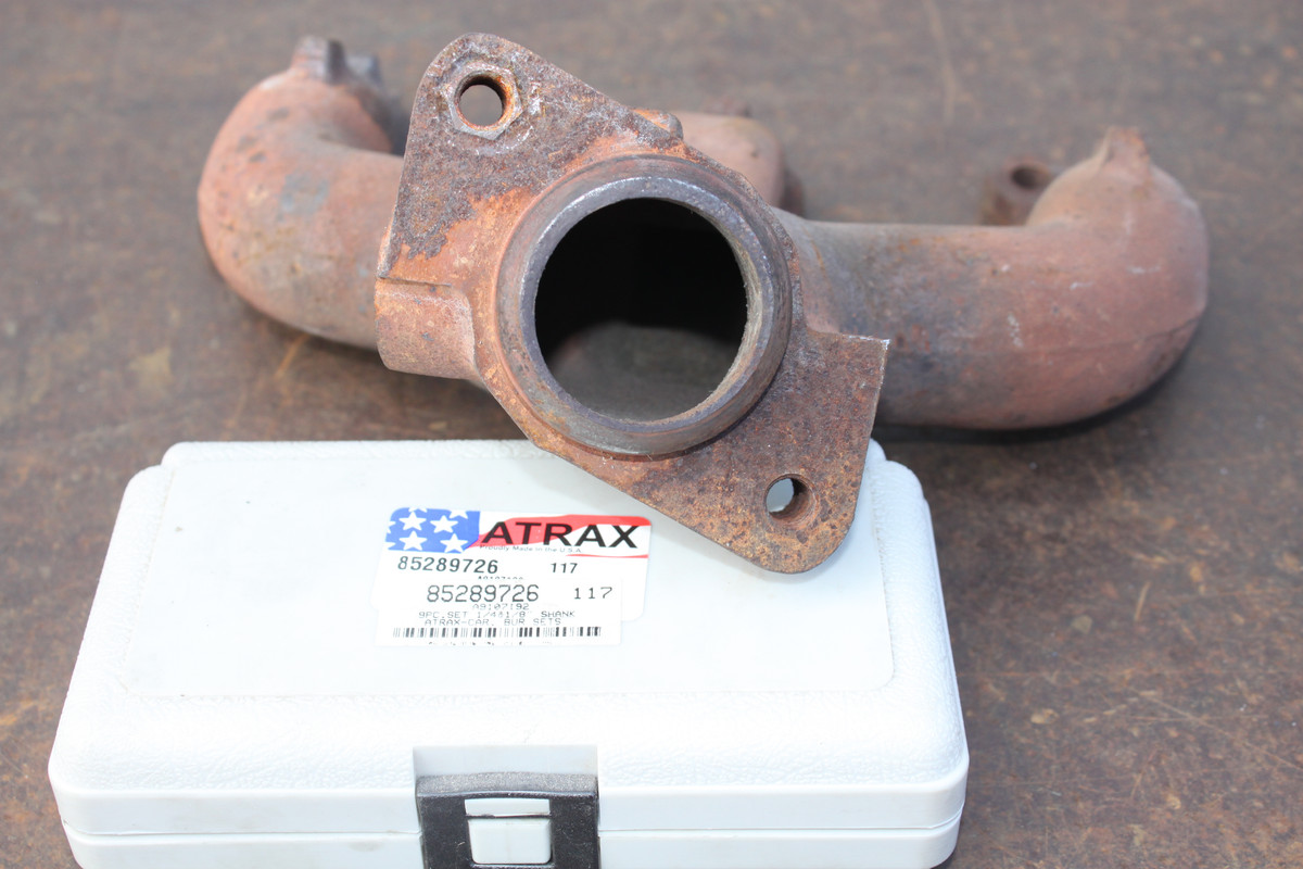

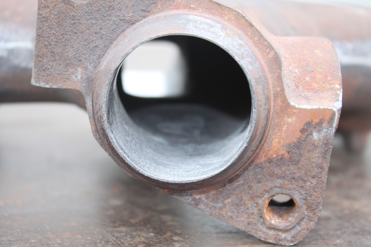

Engine swaps are not a cheap or easy solution. They always cost a lot more then you think they will and always take longer. You are looking at changing frame engine mount perches/towers, changing cooling system, fuel system, exhaust, wiring, etc. If you are swapping to a small block V8 ( 302, 351W or 351C ) you can use the same bellhousing and transmission. But you will need a different flywheel. The 300 is a neutral/0 imbalance where as the V8 will be either 28 oz. or 50 oz. depending on which engine and it's age.
The 240/300's can be built up on a budget. The intake and 4V carb would be the most expensive parts unless you got into the engine farther. How much it cost to build or upgrade one depends on how far you want to take it. And how much work and or fabrication you can do. Used performance parts are out there but it may take some patience to find good deals on them.
I prefer multiple carbs for mine. I really like the 2-2V carb set up. on the 300's. But I'm not going to spend $500 on a new intake. So I'm building my own. I've got less then $100.00 in materials ( building one out of steel ) in the intake manifold and I picked up two used Autolite 2100 2V carbs for well under $100.
You can pick up a pair of used 1987-97 300 EFI exhaust manifolds for $100 or less. These are basically two cast iron shorty headers. They flow much better then the stock carb exhaust manifold. And with some porting they can flow even more. And they don't have the headaches/issues that headers do.
Here's the outlet on a stock EFI exhaust manifold.
Here's the same outlet after I ported it. And doing this costed me nothing more then some time and a few dollars in consumables.
I love the 240! I've got 7 or 8 of them in storage right now. But I would stick with a 300 in a F250. In a car or half ton truck the 240 is a great choice. They make less torque but love to rev! Just look at the little 1V carb that came stock on the 240 & 300's . How well do you think a 302 V8 would perform with that carb! Get the 240/300 to breathe and they really wake up.
Pretty cool work you've done there! Your slowly convincing me to continue with the 6. Couple questions, as it seems you've been around the block when it comes to these engines.
1. Could you tell me a little bit more about the 2 x 2V set up? I've read that a 600cfm carb on a stock 240/300 is a bit much for the engine. Wouldn't 2 2Vs be overkill as well? Obviously I am wrong as it is a popular upgrade, but I don't know enough about carbs to make sense of it. Just looking for some explanation!
2. How does one port an exhaust manifold? I've heard the term lots and I know a little bit about it, but have no idea how to do it. Is it difficult? I would like to learn these things while I have the opportunity.
