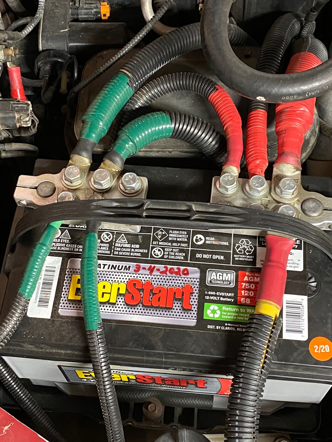

Originally Posted by Squirrel13
Those are nice, but I would feel alot better if those had terminal covers... Dont drop the wrench'
I did the DIY cables. Went larger on the cable also.
Passenger side
Drivers side
