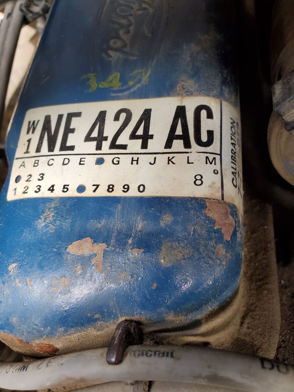

3 - Sticker. Most of the stickers in the engine bay are in pretty good shape, including this one on the passenger side valve cover. Can anyone tell me what it means? I have a feeling this might not actually a 351w. Admittedly I'm quite new to old engine architecture.

How many bolts hold the valve cover on? 6 or 8?

The right-hand side of that sticker on the valve cover contains the engine's Calibration Code, you might need that if looking for certain fuel & emission systems components. The rest of the sticker has to do with the assembly line and isn't useful for anything.

The valve cover has 6 bolts (is that a 351w), and there are only 3 modes on the wiper ****, with a push in (I believe for wiper fluid). I'm guessing I'll have to replace the park sensor.

That is the 351w.
