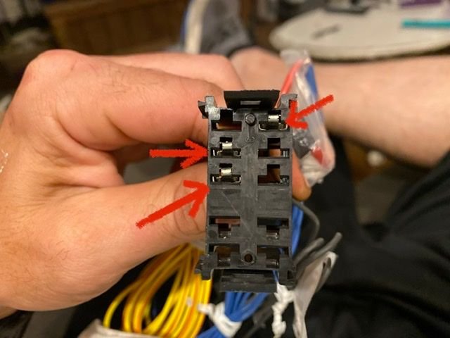

Need a part name
I have a switch I want to use for my locker that's back lit. I'd love to use this socket pictured below, but I need the proper pins or receptacles or whatever to fill the blank voids for the other circuits. What in the world do I need to look up for the proper part that inserts in there?

Those look like 5/16" female spade terminals. You may have to release one from the plug to match it up. Molex is one of the more common manufactures of terminals and molded holders.
I pulled a 7.3 harness from a junkyard donor so I have terminals on hand that will work with my truck.
https://www.molex.com/molex/products...ire_connectors
https://www.molex.com/molex/products...less_terminals
