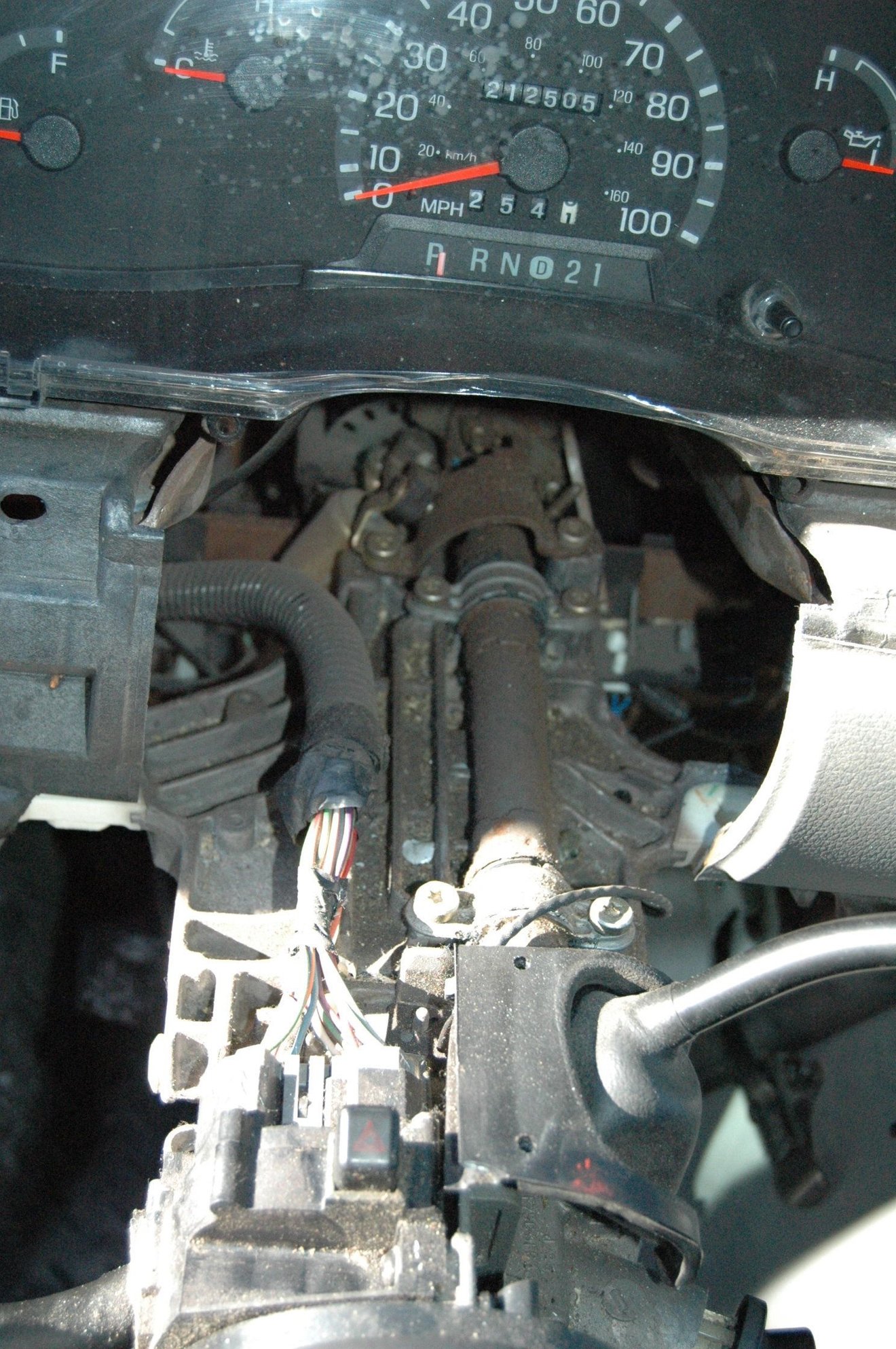

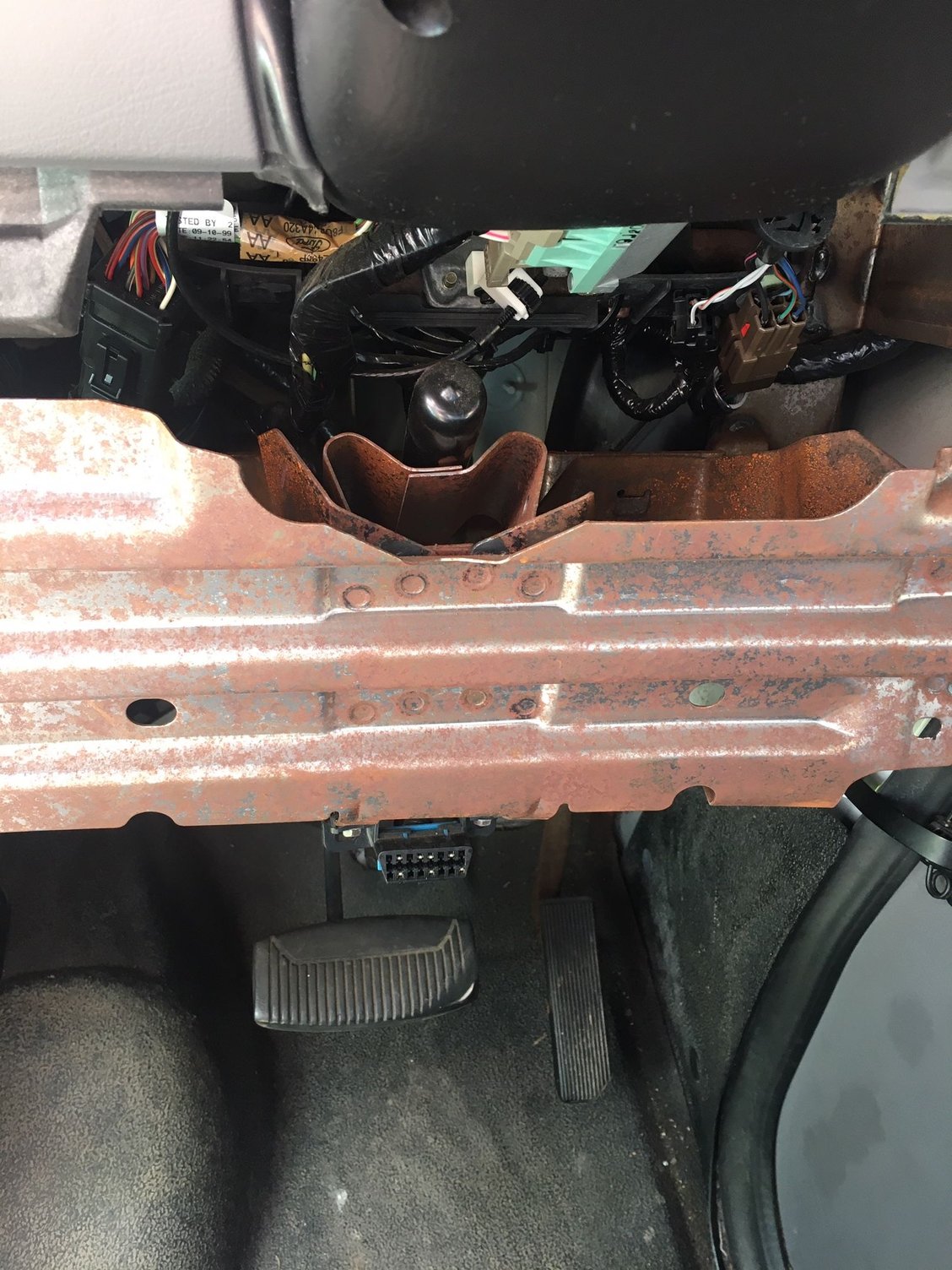

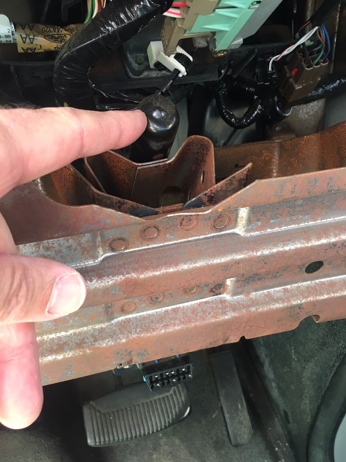

Hi, thanks again for your help, here are a couple pics, this is a bit different from the videos I've seen on Youtube (those are mostly Explorer models). The question is, do I need to take down that big piece of metal to let the steering column down far enough to replace the bushings? Here's a couple pics. I'm also seeing a long tube that runs sorta parallel and under the column, does that affect what I'm trying to do here? Apologies for the huge pics.

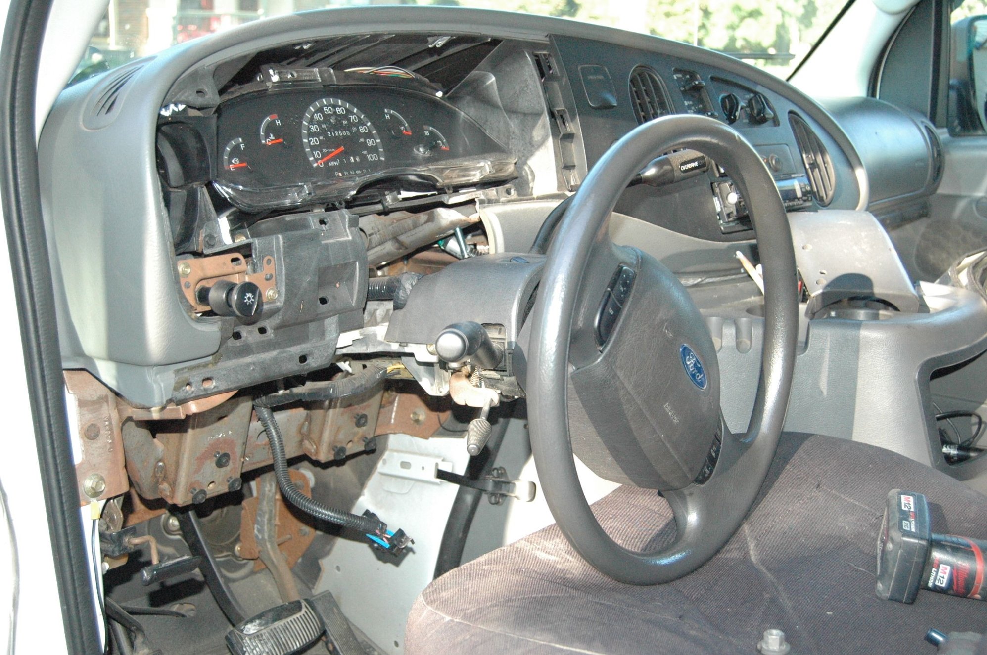

This is what you want to accomplish:
Once that's done you'll have this view/access to the upper part of the steering column:

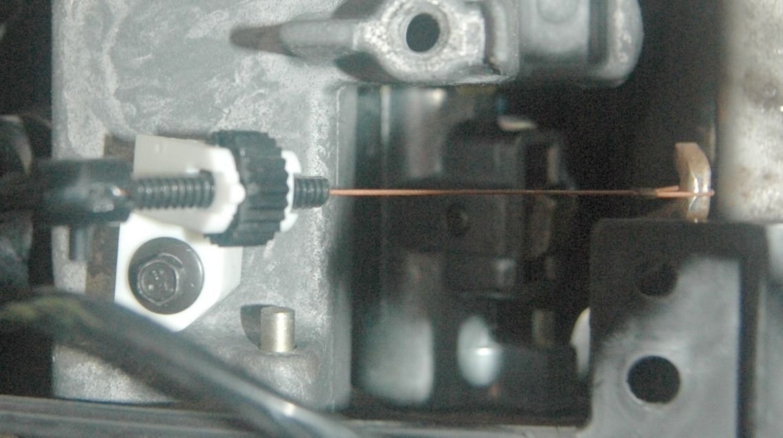

But BEFORE you drop the column you must locate and detach this part of the instrument cluster:
This ^^^ is attached to and part of the instrument cluster---its the gear indicator I mentioned earlier. If the column is dropped while still connected the string will break, you'll have no idea what gear has been selected by the shift tube. It is part of the instrument cluster and can be replaced but better to simply disconnect it and save that headache.

If a picture is worth a thousand words, these are worth ten thousand. Thank you. We have the same model van, and I spotted that cable you mention. It looks like a 10mm bolt, If I remove that and remove it from the hook am I good to go?

Yes however that bolt is more like a 7mm or 8mm--the photo is in extreme close up.
