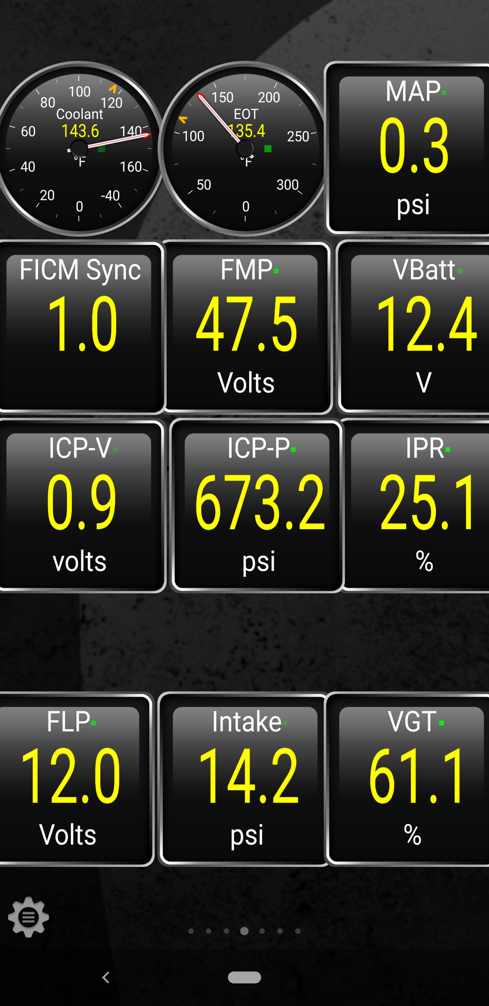

I swiped an android phone from my wife (Google sends them to her to test), and loaded TorquePro on it. DieselTechRon (miss you brother) has a video with config help, and now I'm able to pull data from the truck. Can't do the buzz tests, and stuff, but I can monitor. This weekend I'll have AE up and running too...
The attached screenshot from TorquePro is during the rough idle phase... Sorry about the size of the image...
