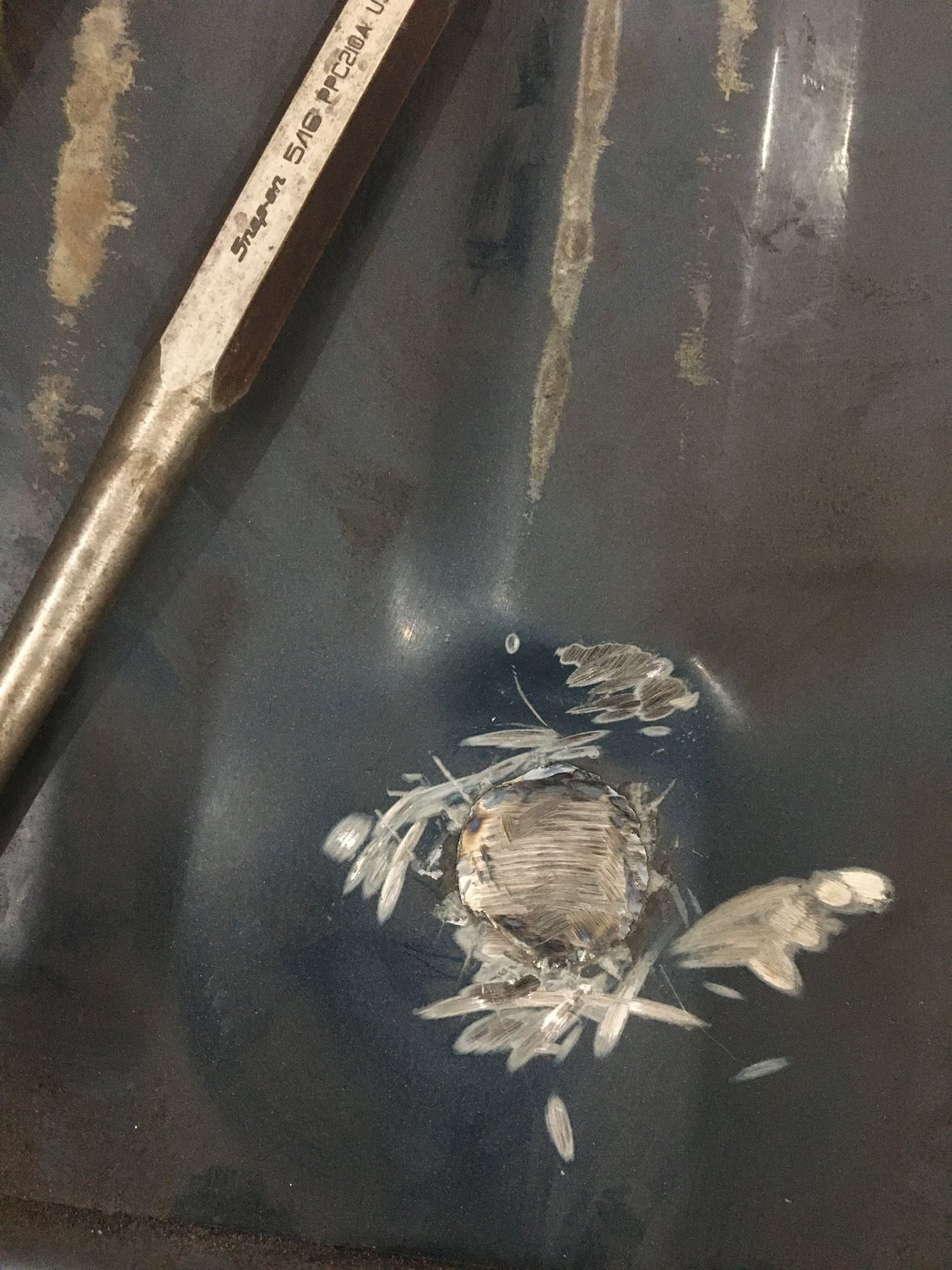

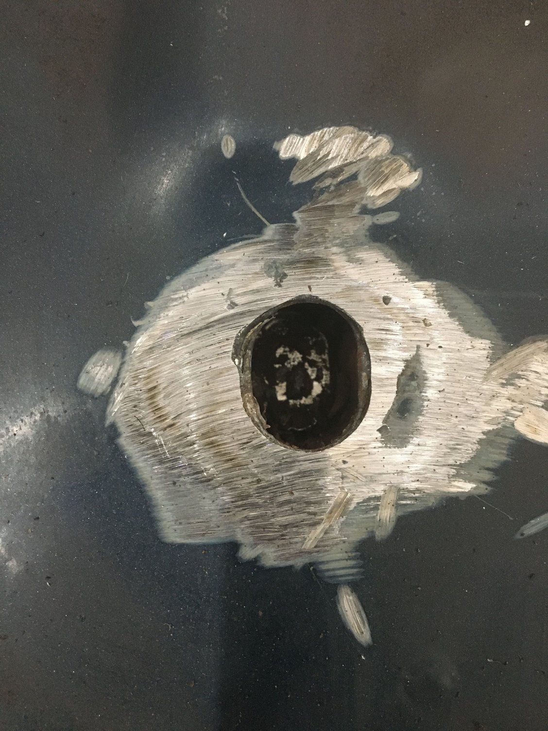

I ground the head off. almost to the bed, just a sliver left. used a small chisel to chisel the rest of the head off. then used a punch to drive them down through.
The bolts pulled though the bed when i lifted it off, they were pretty much driven down to the frame at that point. I had to help one through as i lifted. i think i just lifted up by hand on the one corner and helped it through by jostling the bed around slightly, i was using an engine hoist to lift it off by myself.
Anyway, This is what i did and it worked for me hope this helps you out.
Edit: For some reason i was assuming you had the same style/year as mine. The grinding you see on the bed floor around the bolt holes was just enough to clean up the edges and the rust. very little was taken off. I plan on using grade 8 or better bolts and large washers to reassemble.
Bolts - youll see they are not round - they are oval, they work the same as a carriage bolt.
Ground down to just a sliver left, then chisel the remainder of the head.
Then i used a punch to drive it down. it pulled through as i lifted the bed.

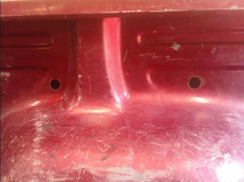

Just to be sure you've got enough input, here's my 2 bits: When I pulled my box last fall for a goose hitch install I wanted to figure out a way to keep the fender arches from rotting thru. Pressure washer thru the center stake pocket won't do it. I cut open the side of my '90 and here's what I found. I then cut 2 1" holes on either side of the stake pocket where my pressure washer can be stuck in and blast. I plug them with 1" plastic body plugs, NAPA, National Bushing etc carry. Very happy with this. Larry
Showing the pocket that collects dirt, turns to mud and never dries out. Salty mud in MN
1" clean out holes

Hey, those holes are a good idea. I’ve always reached up and sprayed them with oil every year. Even a couple of times a year to really get it good and soaked. A garden hose flushes them out fairly well from the bottom, but never really cleans them out.
I’ve had good luck with it in that area. There is so much salt used where I am, it’s a necessity every spring to do it in those areas. I have so much dirt and oil up in there now all stuck and preserving, I don’t really want to pressure wash, just rinse out as much salt as I can, and keep it soaked with more oil.
good tip, thanks. I think I’ll do that myself for easier access. Funny how you never think of the simplest things.
