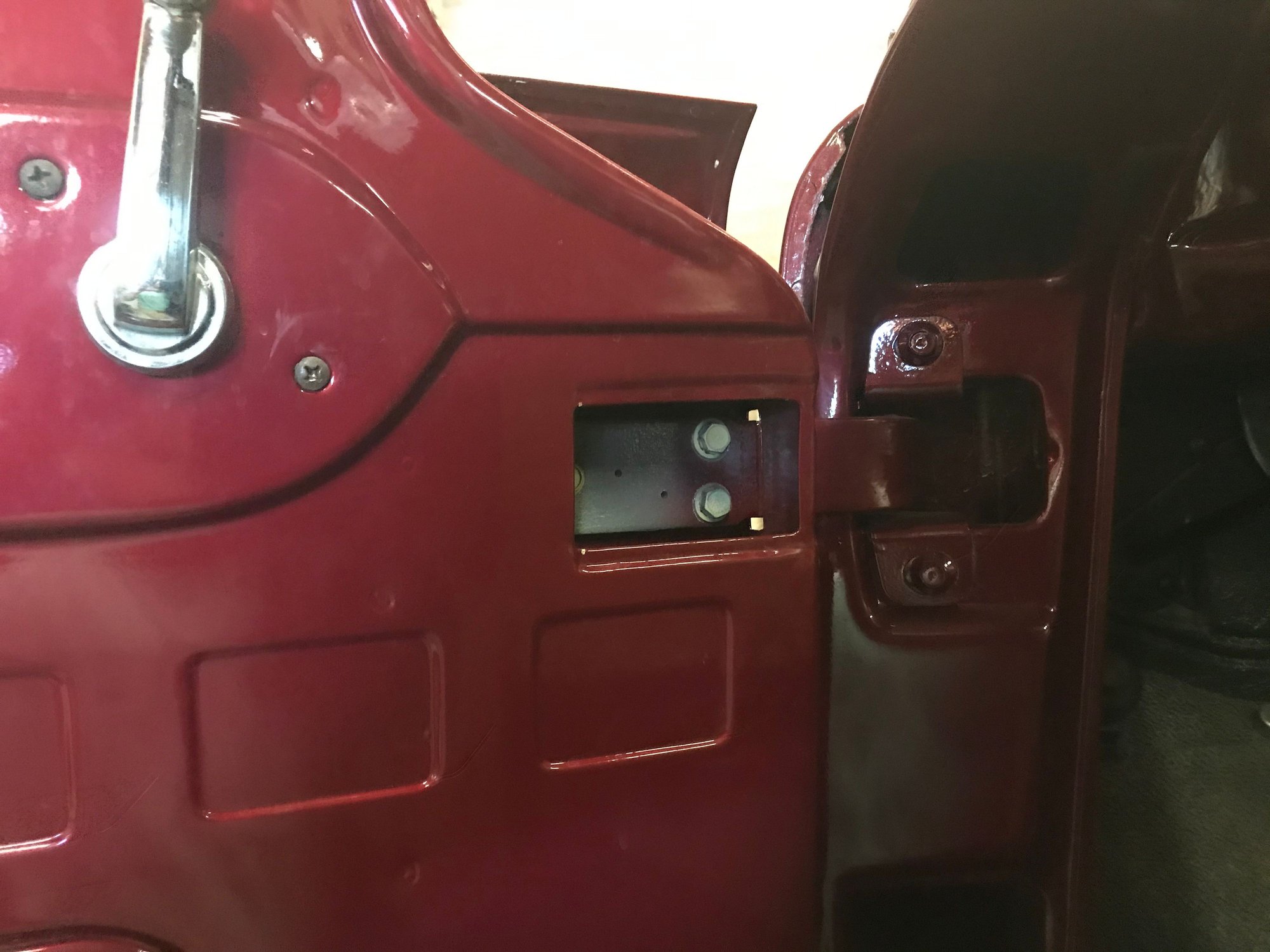

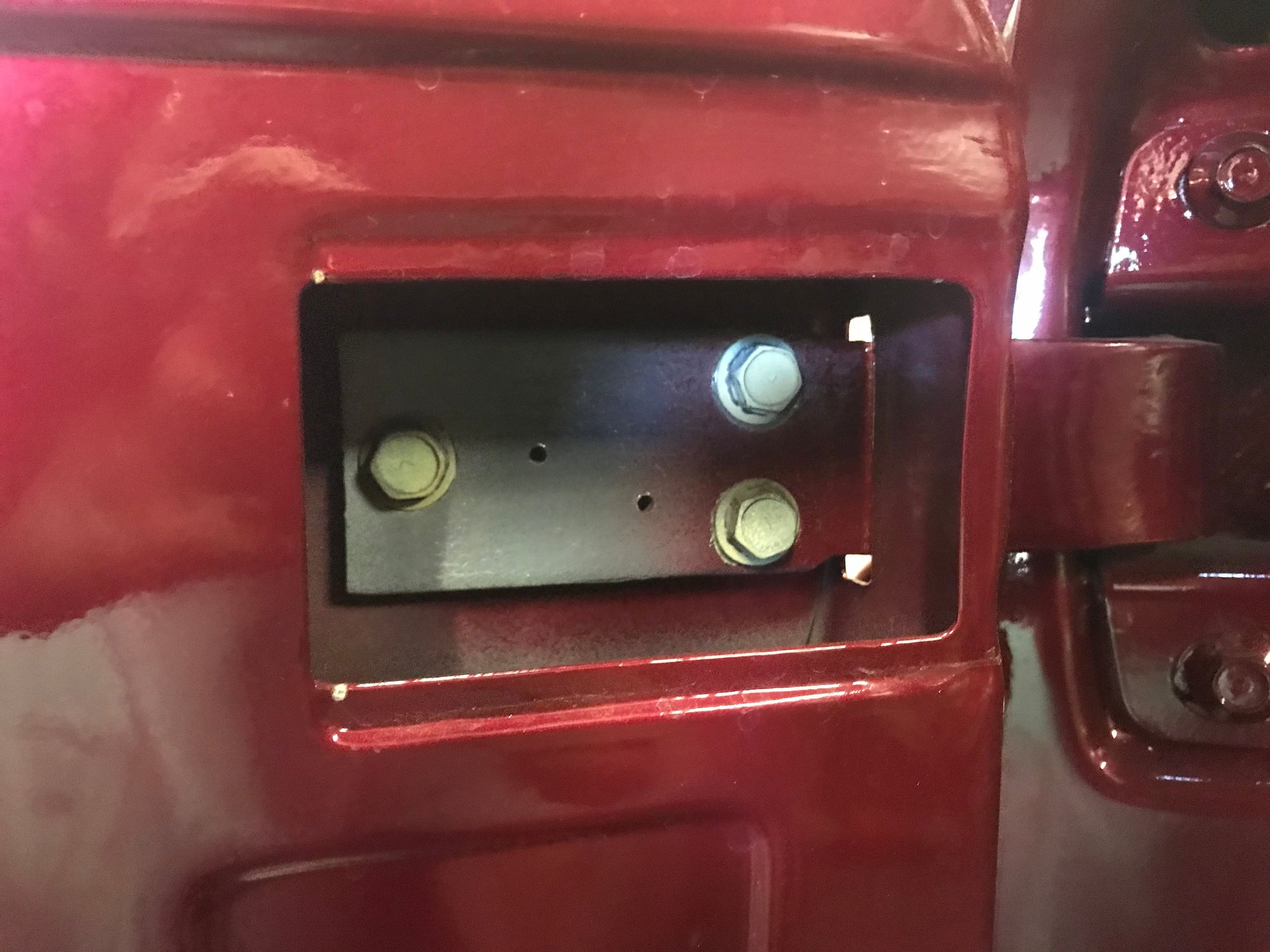

Doors
I do, but requires planning before disassembly and painting. Set your alignment up for the doors then drill 2 holes that are 1/4 inch diameter thru each hinge plate and bracket. When you reassemble use 4 drill bits in the holes to get them to return to your original position
I haven’t taken mine off yet, do you have any pics for clarification? I think I follow but not certain
Old Jun 14, 2020 | 01:13 PM
MARC's Avatar
MARC
Joined: Sep 1999
Posts: 436
Likes: 32
From: Sonoita
Holes much smaller than 1/4 inch
