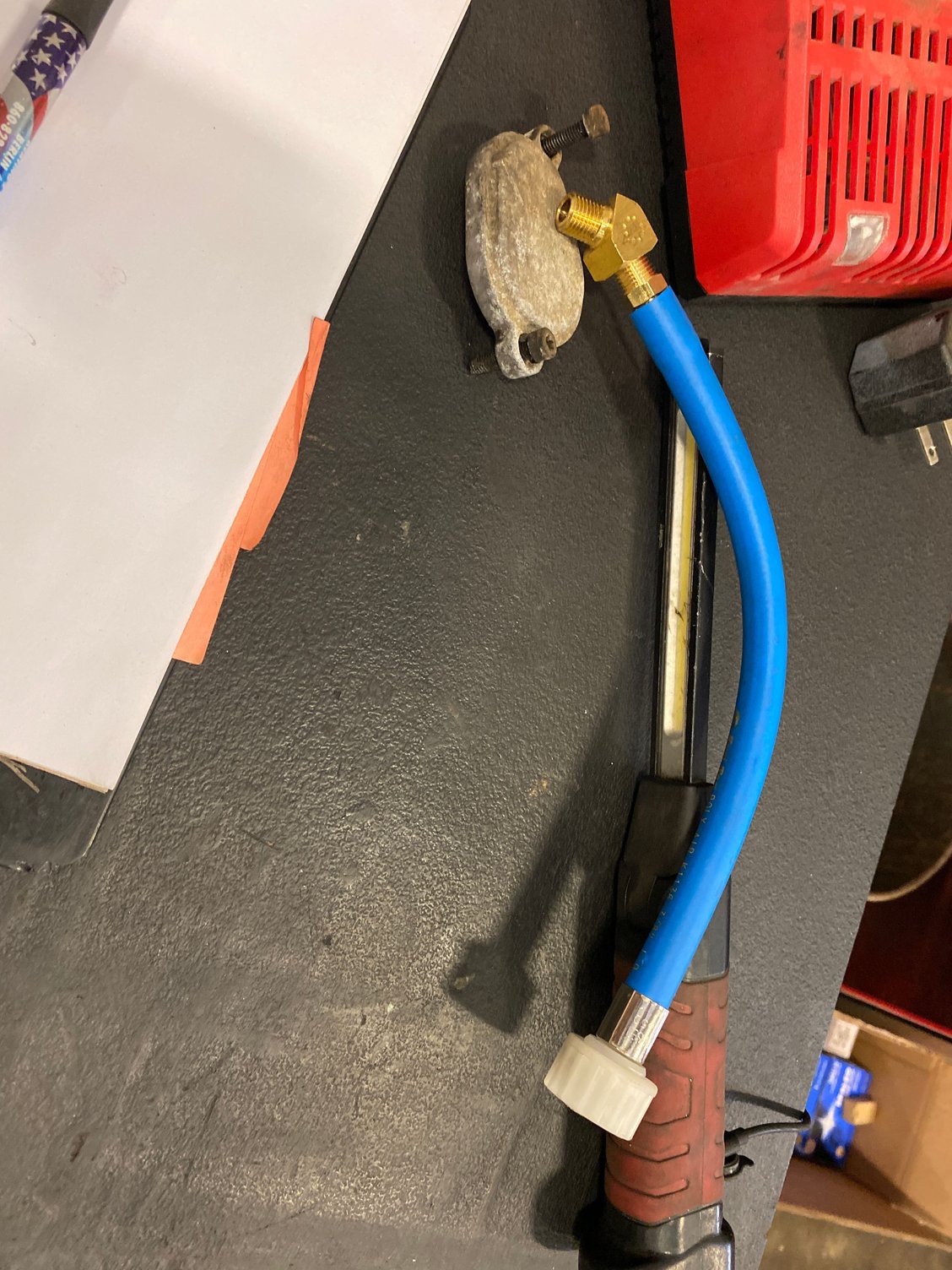

I had a parts engine I took the cap off and make a DIY back flush set up for.
I attached a picture of it below. This should flow coolant thru my Egr delete pipe as well, right?
I just didn’t want to spend $100+ dollars on a kit when I made one for practically nothing.
I plan on doing the back flush this weekend

You have to isolate the flow through the oil cooler. The OE cap will not do this. That us why biscuit head Hewitt uses a hose that fits into the oil cooler hole under the cap. XDP sells one as well.

Okay, I guess I will try hewitts method.
https://www.homedepot.com/p/Everbilt...2361/207144408
will this hose work properly?
I assume I just need to get a garden hose attachment for the other end
I just don’t know if I need 5/8ID or 5/8OD to get a nice snug fit inside the oil cooler

After some more research I found this is the hose I’ll need
https://www.homedepot.com/p/UDP-5-8-...6012/304185144
with one of these to hook up the garden hose
https://www.homedepot.com/p/Orbit-5-...7980/204735780

Flushed out the cooler for about an hour today. The hose set up from Home Depot worked perfectly.

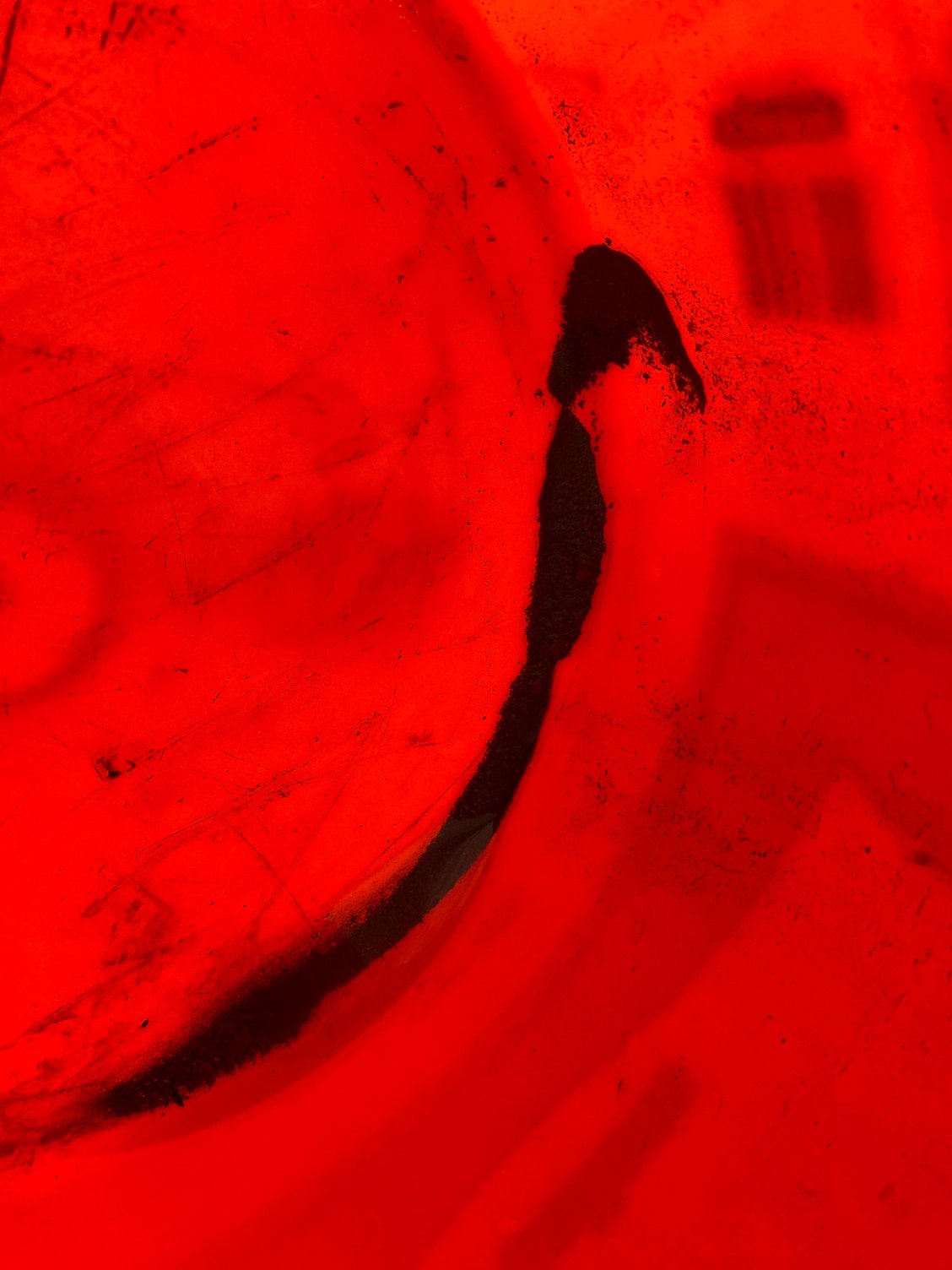

but I attached a picture so you can see what I was able to get out of the system
