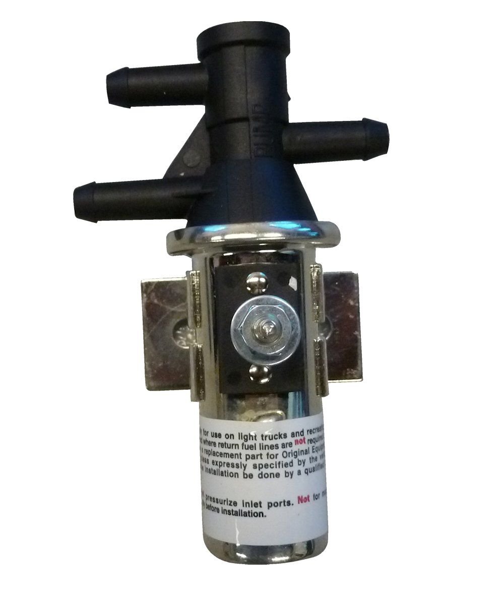

Just to be clear, is this the fuel selector valve you replaced? Sorry the pic came out so big.
Dennis
Old Jun 8, 2020 | 09:56 AM
Kerby76's Avatar
Kerby76
Joined: Apr 2019
Posts: 53
From: Gilbert AZ
yep that is it from LMC

That is the standard replacement valve. The valve defaults to the forward tank, ie. when the truck is off the forward tank is connected. When the truck is on and the selector switch is set to the Aux/Rear, power is applied and the valve moves to connect the rear tank to the fuel system. Block, chock, and remove coil wire from truck, safety first! Remove and plug all fuel lines from the valve. Use a flashlight to see which of the stacked ports the valve is blocking. Use a spray lube to clear remaining fuel from the unit. Put selector valve to the Rear tank and turn ignition to run. Look into ports again to see that valve has moved. Wait the 4 minutes that you timed the fuel starvation during the drive. Check the valve and see if it has relaxed to the default port. If so, check the supplied voltage before turning truck off. If voltage is good, valve is bad. If voltage and valve are operating properly, then you have a clog or no fuel issue between the tank and the valve connection.
