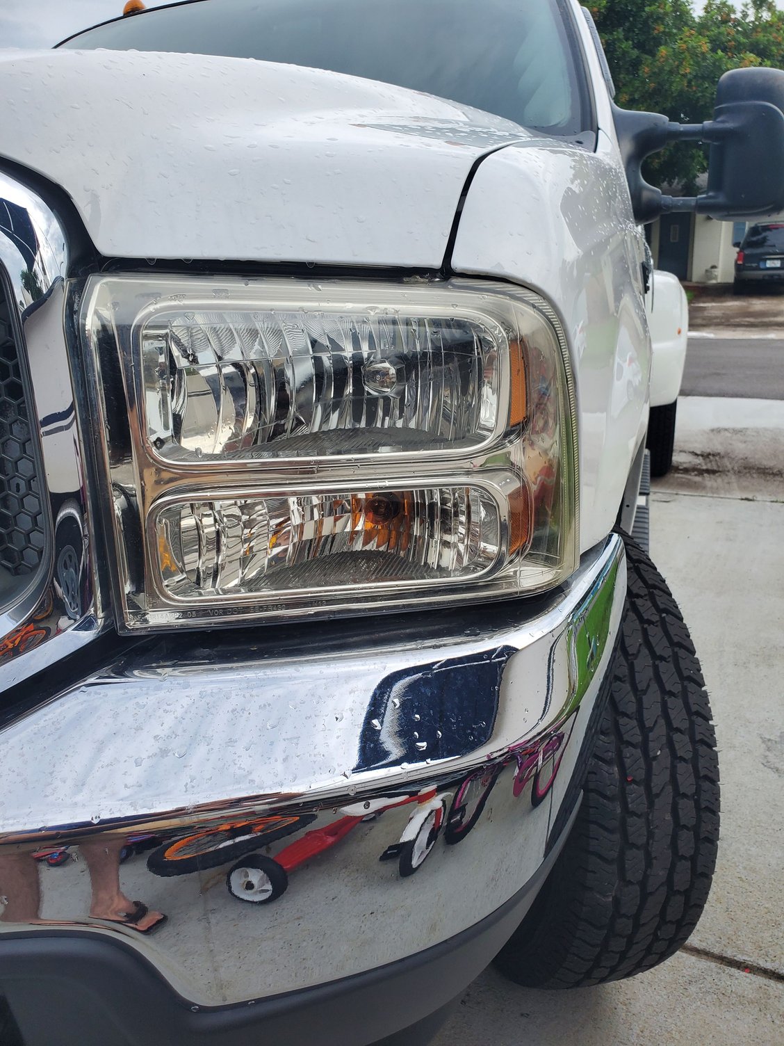

Originally Posted by Whitey Ford
Nice dually! Is that a Florida dealer tag on the front?
Yessir, It is my grandfathers old tag. He lived in Milton, Im around 1.5 hours north in south Alabama.
Originally Posted by Listor
I like that look, thought about going to led , but not sure about it
Thank you, I had to cut the plastic in the radiator core support but it wasn't too tedious of a job!

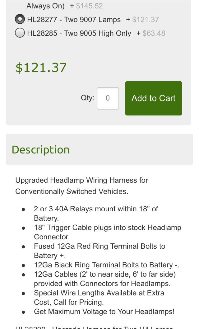

SSJ , do you basically run all new wiring for this relay upgrade? I just checked my lenses and much to my suprise the previous owner put in eagle eye lenses but the put in leds and i dont like them. As you described there is not much light down the road and I also don't have a high beam. The bulbs are kinda just stuck into the socket and just knowing its like that drives me crazy. Would really like to get this done correctly. Is there any write ups on doing this upgrade?

The harness is plug and play.
Youll fasten relays to fenderwell, run the fused 12v wire to battery, starter solenoid, etc and the headlight pigtails to bulbs. One of the old headlight pigtails plugs into harness for triggering relays.

Does this look about right? Conventional switch system on our trucks? Just don't want to order the wrong one, thanks

Yep. Perfect!
