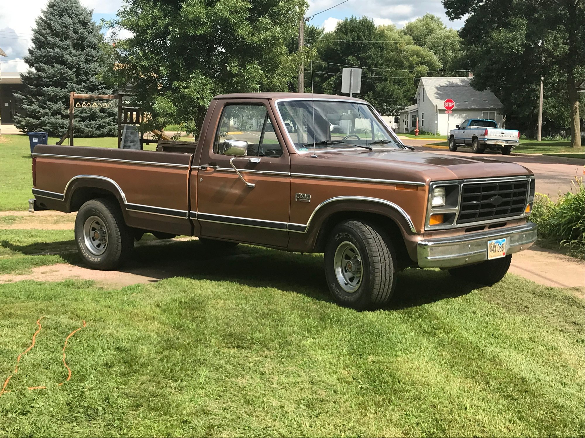

Anyone running 32x11.5x15 with no lift on their bullnose? It's time for new tires and I want to go bigger. Currently running 235x75x15 on my 7"x15" 5 slot mags (that I want to keep using). Post pic of what you got, and how you like them.
Thanks, Joe.

Thanks for the help guys. It’s a 4x4 351w 4 speed manual. I say no lift because I don’t want to lift mine. Maybe a front leveling kit, but that’s it.
