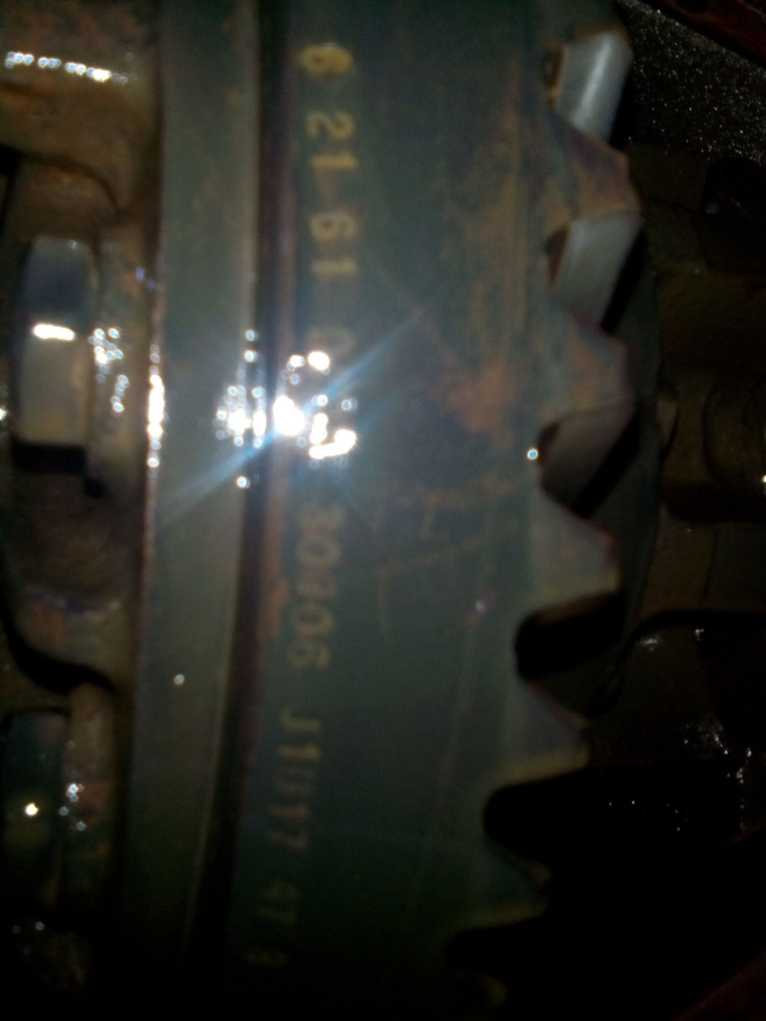

I'm trying to get my 1962 F-350 back on the road and am currently working on the differential, I've looked around and haven't been able to find out much of any info for to on the truck or online, all I know is it has a 5.87 gear ratio and ten bolts holding the back cover on.
also will any gear oil work or is there a specific weight I should get?
Edit: the limited amount of info I was able to scribe off the attached tag is: CITT-U 2443-3 7-61 5.87
Diff ring gear markings " 6 21 61 DANA 30806J1U17 47 "

If your warranty plate is still attached to the inside of the glove box door take a pic of it or type in what it says. We can tell you from that what it originally came with assuming it is not a special order axle.
Most common in a 1962 F350 would be the Dana 70 or a Timken B140.

Between the 5.87 ratio and the Dana it's fairly certain that's a Dana 70. The Timken axle was a 5.83 ratio.

alright, thanks for yalls help, sadly the warranty plate is no longer there, its been passed thru 3 hands before me so who knows what all this truck has been through.
